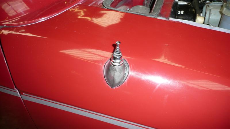

This is the type I need.
- aerial.jpg (41.04 KiB) Viewed 870 times
