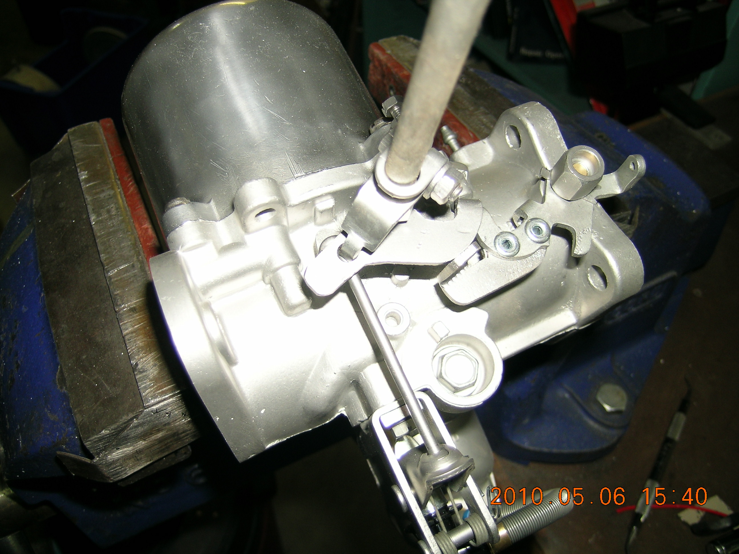

What kind of choke linkage will you use - if any?
I have looked around for the parts and cannot find any.

Carl is running HS8s on his car with BAW needles and .100 jets.
I made my own choke linkage for HS8 carbs.
HS8 MKC.jpg (140.81 KiB) Viewed 6876 times
HS8 M CH.JPG (927.01 KiB) Viewed 6876 times
