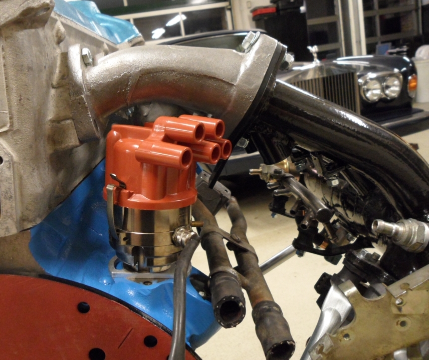

If you are going to spend that kind of money John, I suggest you also consider a 123 distributor.wheels wrote:http://www.aseriesspares.co.uk/ignition ... t_113.html

The one for a Spitfire 1500 can fit a Sprint, you need to fit a side entry cap and change the drive gear for the Sprint one (needs an adapter
that any machine shop will make easily). A Dolomite 1500 distributor clamp can be adapted to suit.

I just tried various Dolly models and it doesn't seem to fit any of them!

Having said that, if a 123 can be made to fit I think I would go for it.

123
Re: new dizzy
Jeroen, looks perfect but which 123 distributor is that please? When I asked them recently about one for the Sprint they said they didn't do one. I need it to go under a Weber type inlet manifold.
