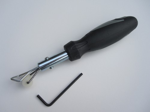

I need to fit a screen chrome plastic trim to my windscreen rubber and its a job I have never done before bizarrely after
owning dollies so long.
Ive got this funny tool like a screwdriver with a small square ring on the end that's supposed to help.
Any tips?
Any tips?

Yep - throw it away!
I've heard of people having success with these, but I've only tried to use one once, and it damaged the trim.
Use silicon spray, or washing up liquid, or anything like that and the good old thumb, it worked a treat for me last year.
Impossible without lube though.

I managed to do this with only a flat bladed screwdriver and plenty of care. Best to put the new trim in some hot water to soften it which will make it easier to fit.

What you need is one of these...
...which has a roller to push the trim into the rubber. Used in conjunction with a spot of baby oil. Used many times and much easier than thumbs.

You might not need to use the tool, depend how old the rubber is. I fitted one a couple of weeks ago to a new rubber and it went just easily using a bit of lubrication.

For various reasons its an old stock seal and its been in the car some 7 or 8 years with no trim.
So it was a little stiff but a nice warm day and plenty of red rubber grease and it went in with odd use of the
loop tool, a couple of screwdrivers and some knackered thumbs.
The odd youtube video on old mini screens which have a very similar if not identical trim was also helpful.
