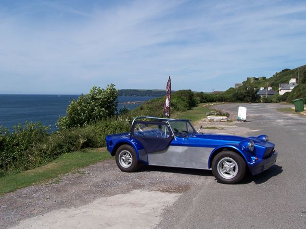

Hi all, been of this forum for a long time, what with ill health and then trying to wind up my business because f the health etc. Anyway, to the sprint powered kit car. It has proved to be ultra reliable, except the overdrive, but that is now sorted, nothing more then crumbling wiring in the tunnel. The engine is running superb, almost afraid to "fiddle". Rebuilt the SU carbs beginning of last winter, followed by a John Tilson set up, 2nd time got it right (ish). Fitted a electronic ignition unit from the landie people and a new cap and rotor to suit. Still running the straight pipe exhaust but now with a Kawasaki ZR12 silencer that came my way from a ex superbike rider for free. The car starts on the button and does take a few miles to settle down, then it goes and sounds awesome without being to loud. The car weighs less then 10 cwt. and the mid range torque as I heave away always brings a smile to my face (stupid grin). I recently did a job for a local tuner in return he put it on the rollers, 124bhp but he was afraid to touch those funny things (carbs) and couldn't find the ECU ! Today I went up on to Dartmoor and gave it some stick around the lovely stages I know of. Car went perfect, so then I nipped back down to Plymouth and sat on the cliff and had a 99. watching the ships come by. My only concern is what temp should it run at? I'm up at 200f I think thats 93c, doesn't get any hotter but should I turn the stat down a bit to get the fan to kick in sooner. Well thats all, unless any one knows how to get rid of backaxle back lash, it sort of spoils the car that slop on take up and over run. I suppose now I'm semi retired I have the time to DIY it.

I spoke with my elder brother, he knows lots even though he is in his 70's, (age wise and dress sense !) and he reckons the best way to do it is pull the lot out, so may put it off 'til the dark evenings come and that X factor thing, that means I can escape and hide in the cave and get oily
. Seems I should be running mid 80's degree C. not low 90's. Been advised to direct air into the rad more, seems it may be escaping around the sides of the rad, line of least resistance, so today I am cutting a template from 3 ply and if it works, will then use alloy sheet.
