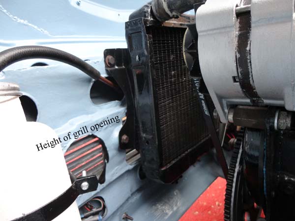

The front design of the 1300fwd is different from other cars insomuch as the grill only lets air in to the lower half of the radiator, the top half is shielded by 'nose' of bonnet and section above grill and have attached some photos to help describe what I mean.
It is doubtful if I could find or afford a new radiator and a second hand one would possibly be blocked like mine.
My thoughts are to fit a 10" electric fan in front of the radiator and move radiator back to make room, after metal four blade fan is taken off. I think with some modification I can fit it in and then the fan would cool a 10" diameter section of the radiator rather than bottom section.
I would appreciate any thoughts anyone has?
Many thanks
Many thanks
- The inside view showing position of grill and where it feeds air to lower section of radiator

If the core is blocked then the rad is shot and no amount of extra air will help! You're not too far from me, give Radiator Services in Telford a bell, their number is 01952 613498, they've done loads of weird and wonderful rads for me and they're not too heavy on the pen. Oh and don't worry if they use another name when they answer the phone, they have about 3 different businesses working from the same site!

Doubtful a fan will help if overheating happens on the move.
Really, a cheap modern rad will be more efficient and many available, just pick your size......
