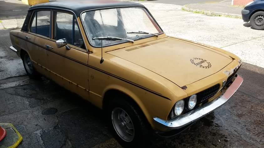

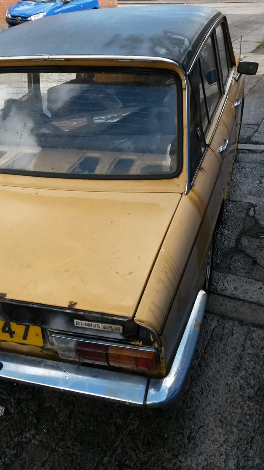

Last week I took this we dolly from certain death. AS far as we know She is the very last of her kind ever registered in northern Ireland. With 65000 miles on the clock. vin no. KLZ5547 reg APRIL 1982 Chassis number VA31178 which does make her one of the last sprints ever to reach northern ireland .she has not had a hard life but some bad tin worm has got in when she was stuck under bushes for nearly eight years her engine stripped out and stripped down and left to rust but thankfully all seems to be present and correct more or less lol..So i washed her down the get out the tree parts and all the spiders washed away. When she was dry I was shocked to see how the car paint on the boot lid cleaned up after over 30 years of wear. When she was dry I brought her in and began stripping out the doors, glass. and the remainder of the interior. Next thing to do was to check the rot ,,,, not nice but had to be done.so I got her up on her side and started to work on the rear of the boot .The boot floor is very bad behind the rear wheels but the centre is useable so I made up a new section for the o/side and began to mig weld it in as you can see in the piks it fitted fairly well and now we have one side of the boot floor repaired ..I would have bought a new floor but £200.00 from rimmers is way to much for this easy made panel.

Unfortunately your car is NOT one of the last Sprints made, it is one of the last ten which were allocated the early VIN with the VA prefix. This changed on 01 09 1979 when new 16 digit VIN were introduced. There are many Sprints made after your's which carried the new style VIN.
Had you paid £200 for a boot floor from Rimmers, you would have been likely disappointed with its quality and authenticity. These at £72.00 per side are spot on and zintec coated:

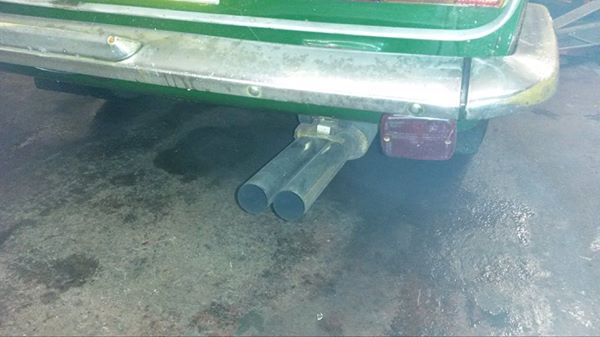

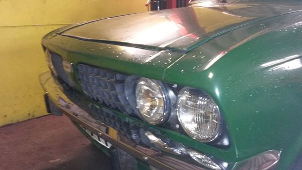

Bought this we runabout while the sprint is still under restoration, ,a 1980 brg 1850 auto ,69k on her and in ok condition, ,,
- 12007306_1641846652740844_1867786774_n.jpeg (33.13 KiB) Viewed 4740 times
- 11992487_1641846752740834_1212130645_n.jpeg (32.11 KiB) Viewed 4740 times
Re: NORTHERN IRELANDS,, LAST SPRINT ????,,,
What's the plate on the 1850 auto? I know of 4 of the same year and colour on my database. You can send me a PM if you'd rather not reveal the reg on here.
