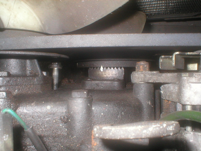

If you still have the original fan and Torquetrol unit it could be the bearings failing. Try wiggling the fan blades and listen for a clunk. I've had 2 occasions of funny noises at the front end.
One was the alternator front bearing. ( Remove fanbelt to check ).
The other was the bolt behind the fan working loose and rattling against the pulley.
- dolly rattly bolt.jpg (115.35 KiB) Viewed 1343 times
Re: triumph dolomite sprint engine knock rumble
Ouch Tony....
That one is also locating your timing chain guide IIRC so hope it went back in pdq...
Yes it is.Jon Tilson wrote:Ouch Tony....
