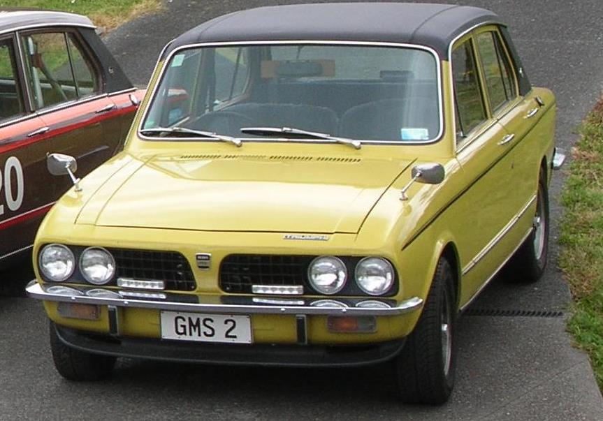

I've run these for a couple of years plus now and find it remarkable how effective they have been. The car gets a lot more respect in terms of road presence than it used to - others move over quicker when I'm in the outside lane of the motorway and they don't pull out of side roads in town as often as without them.
Sure I could put headlights on, but then I don't need to in other moderns I drive as they have DRLs fitted so it is just one less thing to remember.
They are fitted into the grill and wired correctly as they came with a controller that meant live, earth and a connection to a sidelight to read when the power lights were on. Easy. The look isn't original but is better than a stoved in front (and yes I do have spare original plastic grills in case I ever want to go back to original)
Geoff

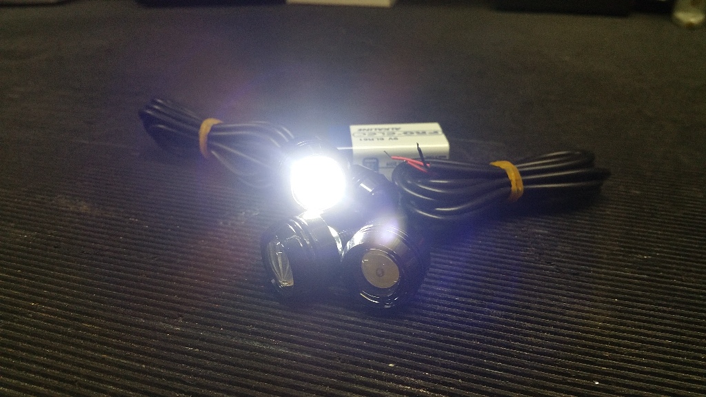

Got me going on daylights now, got these from Ebay, will fit into the grilles for a descrete look,
may even put all four in.
