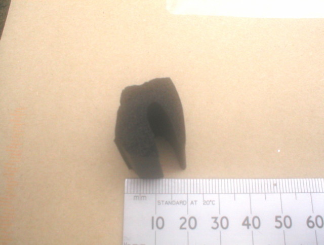

I've been getting water in the boot as well. Mine has the original seal glued onto the boot lid, so I ordered one from Mr Rimmers. This is rather different in that the replacement seal has a groove in it and the rubber is not symmetrical about the groove. It doesn't fit tightly over the lip on the boot so I'm going to try removing the old seal and fitting to boot lid with Evostik in the same way that Dolowighty has done.
https://forum.triumphdolomite.co.uk/vie ... +boot+seal
It looks like the groove in the seal goes inwards in this case.
I'll let you know how it goes as we are promised thunderstorms late tomorrow.
- boot seal.JPG (52.85 KiB) Viewed 2229 times
