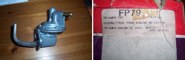

I think that the previous advice is very sensible, especially checking that it is located properly but there is a bit of a conundrum here..
I have just bought a nos later type (it's 'MOPROD' whatever that is). As you can see it has a longer arm but I am a bit confused. Looking at the wording on the diagram in the thread above it could be that you only need a spacer if you are using later type of pump on an earlier engine so, if you have the correct pump, you should not need a spacer. However Rimmers sell the earlier pump for all engines so they should work without a spacer(???).
viewtopic.php?f=4&t=30523

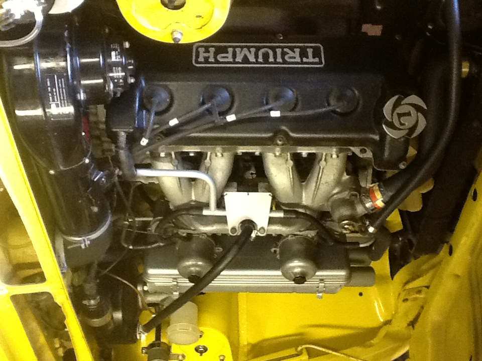

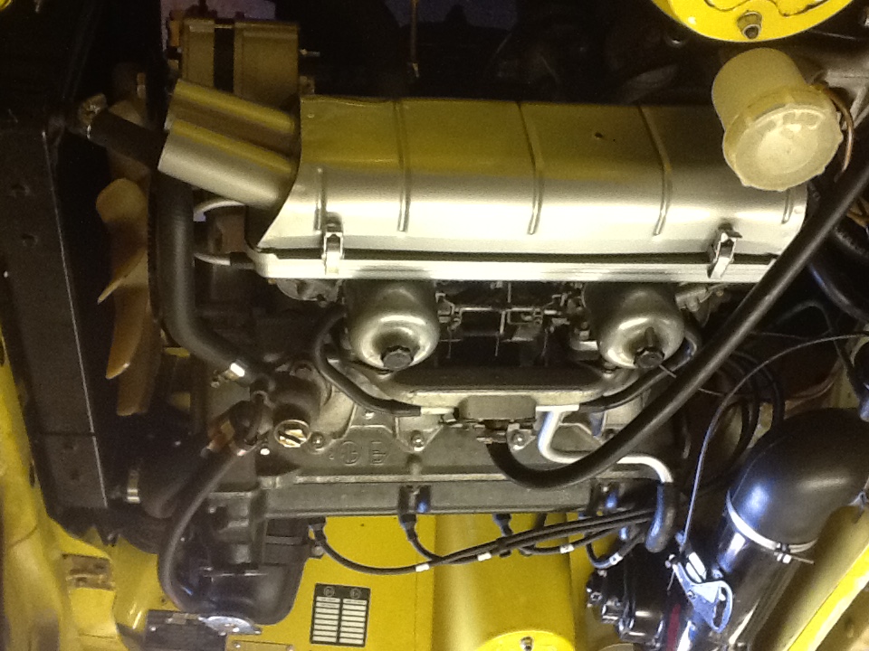

- Posts: 462
Re: Fuel pump , no petrol ??
Photos
- image.jpeg (257.36 KiB) Viewed 2349 times
- image.jpeg (285.88 KiB) Viewed 2349 times
Alan I would not use that pump. The arm is the wrong shape and will probably break when fitting even with a spacer.
Jon is correct, I fitted the exact same pump, with a spacer, last week. It lasted less than five minutes. I measured the arm before installing and, with the spacer, was within a millimetre of the original. Still broke though.
I see the words on the box indicate that it is a TR7 pump. This should be identical to the 1850 / Sprint item.AlanH wrote:This may be the thread that you are looking for
Rimmers quote early TR7 / 1850 / Sprint as 312167 and the late one as TKC3419 with the same spacers and gaskets. So that pump should be O.K. when fitted with the spacer.
Now what worries me is that I have a NOS A.C. RA1 pump which looks like that one which I bought as a late Sprint one.
The operating arm has the number 7990090 stamped on it and the body is stamped 24F4 & 8088.
Have I got the wrong one ?
Have you seen the price of the spacer block ?
