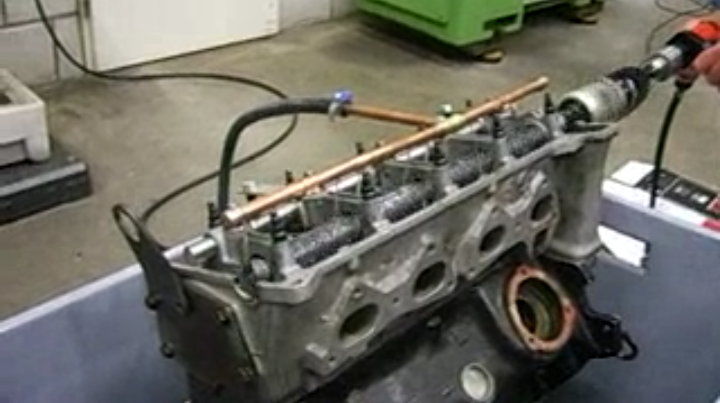

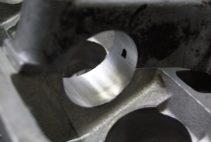

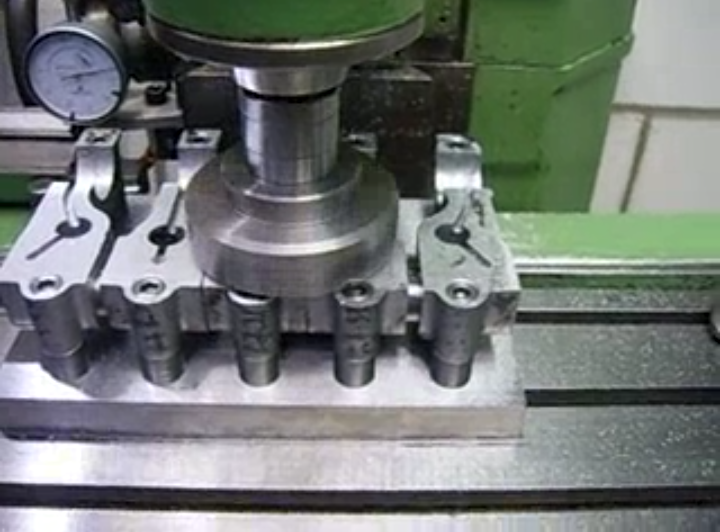

#7 Post by soe8m »
You can always have them shipped to nl to have them torqued on an engine and have all flush and round again.
