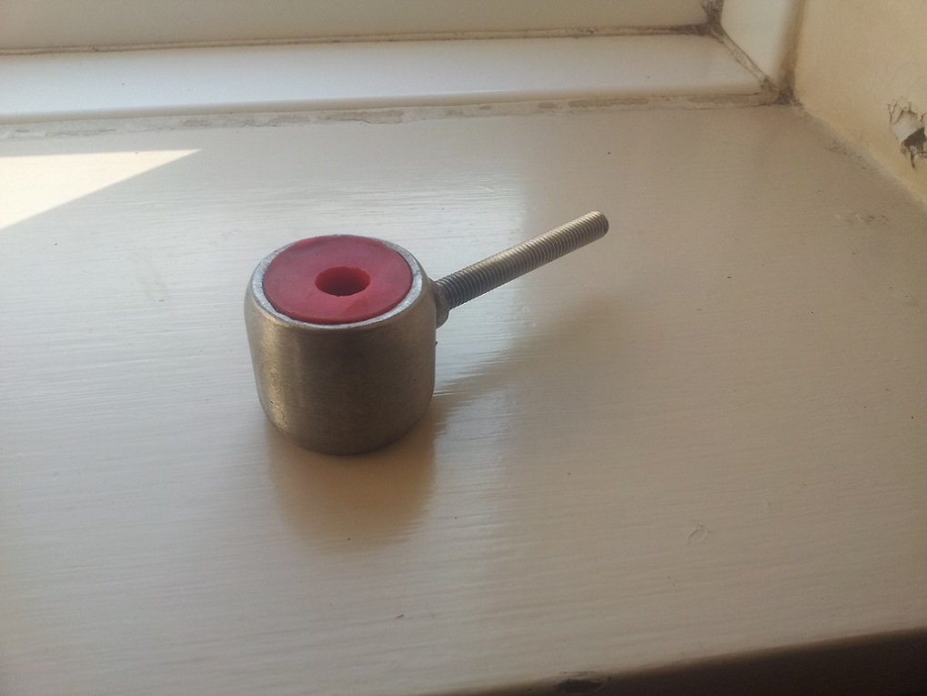

I've had a go at making my own poly ones, they're slightly larger and harder than standard but I think they should work.
I haven't try them yet because the rest of the car is still in bits.
Good luck with yours.

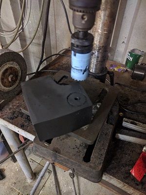

OK..as promised here is my attempt at making my own ARB bushes out of rubber.
In summary..success!! and for the $10 AUD (4 quid) I paid for the block of EPDM rubber, its an even better result.
Make up your own minds, but Im happy and I have plenty left to re-do again if the need arises.

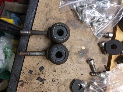

So..this is what I started with..old and very past it rubber ARB bushes:
So, cleaned them out and started to make a suitable sized rubber bush.

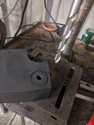

I used a 32mm OD hole saw, so ~30mm ID with a 1/4" pilot hole to begin with. You want a bush around 25mm long to sit just inside the tapered ends of the bush tube.
The block of rubber I used is 100mm x 100mm x 50mm

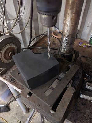

So..drilling a pilot hole of 1/4" all the way through the block. This allows you to use the hole saw from both sides (the hole saw I had bottomed out around 25-30mm depth)
Then using the 32mm OD hole saw, cut the hole..slowly and use LOTS of silicon spray to keep it lubricated as the rubber starts to grip the holesaw, the deeper it goes.

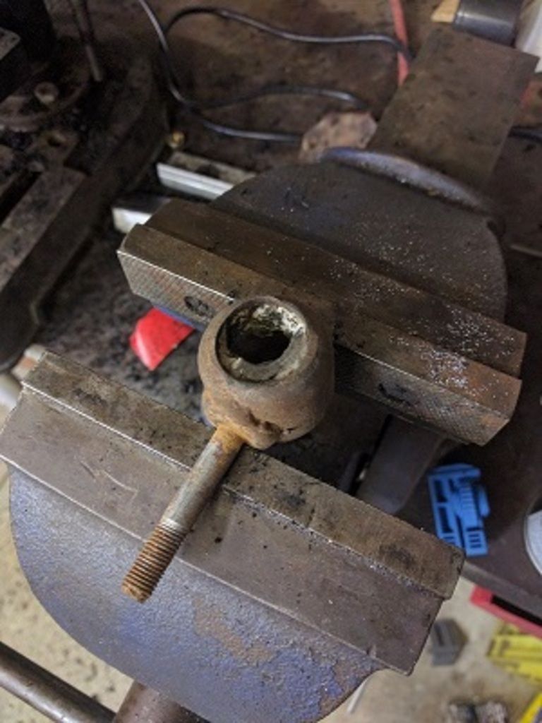

Then..once you have your bush, drill a larger ~1/2" inner hole (any smaller and it becomes very difficult to push the bush home). The ends of the ARB are approx 13mm to they fit nice and snug into this newly drilled hole.

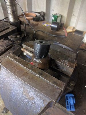

So, once you have your bush, again..jam it in the bush tube, and gradually prise the bush into the tube. I used a large-ish flat blade screwdriver and work your way round, bit by bit being careful not to damage the bush. Use plenty of silicone spray.
nearly there..
Finished product(s)
Nothing spectacular, and a lick of paint might have been nice, but 1.5hrs in the shed with a beer with the music on loud rather than watching some mundane reality home maker-over while cooking show is not bad in my opinion. As a bonus I didnt break anything either as is normally the way.
Hope it helps anyway.
Andrew

Hi Pete,
I havent really needed to check them until your thread!..so I suppose thats a good thing.
Looking thought, they look fine. When the suspension is on full droop they look squish enough but sitting flat they look like a normal bush which I think was some of the comments around poly bushes that might be too hard.
But...I think if I were to do it again, Id get some polyerethane and pour my own next time.
If you are in Perth, then Kirkside do pourable poly down to shore 40 which from what I can read about is better than rubber (apparently ~60 shore).
