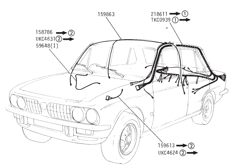

It's been a few years since I removed my headlining, when I did I remember seeing a long single electric wire that was behind the lining. Now I can't remember where it's was routed and I never known what it was actually doing. It's long enough to reach the opposite side of the car to the light switch but should it be connected to anything? I have a bunch of cable's on the driver's side light switch position that I assume would be for a LHD car, but this single wire is a mystery, any thoughts?

Which one you thinking? (I was surprised to see that all rear electrics go via the roof!)

Thanks for the replies, it's not a surprise that there's no standard, but looking at the picture, thanks Galileo, I'm thinking its the one across the roof, 159863. I will have to look to see if it's obviously detached from the driver's side. Thinking about it I now have a big hole in the roof, don't ask, that the Webasto will go into, so it will not reach now. Headlining is being fitted in couple of weeks so I need to sort this out. Will try and add pictures as well but have never been able to post them.

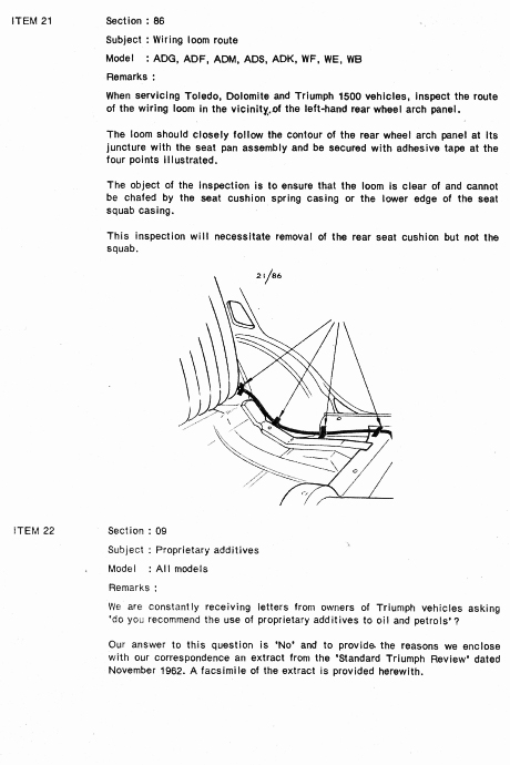

You will only be trying to pull up the A pillar the wiring for the interior light and the feed which goes across to the RH rear door. That wire is taped to the roof and sits under the sound deadening pads which are also glued to the roof.
I found that there was ample room for those two (?) wires and their connectors but certainly not for the main wiring loom and all its plugs. My battle was sliding the male connector of the radio aerial down past all the obstructions.
Here is a copy of the Triumph Service sheet which makes reference to the main wiring loom which runs across the floor on the passenger side. It is self explanatory.
