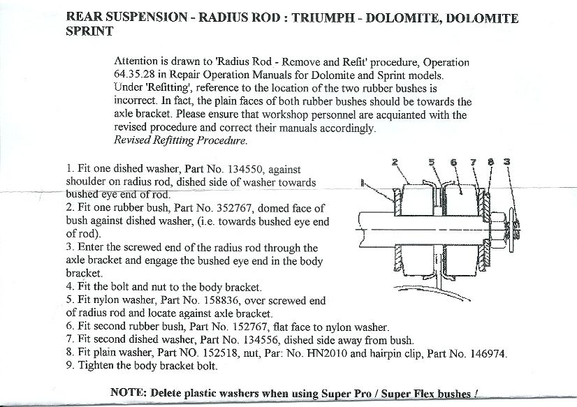

The factory did revise the fitment of the bushes and dished washers
Dolomite washer0001.jpg (245.37 KiB) Viewed 866 times
I've always followed this.

Interesting! I have therefore fitted the bushes and the "inner" dished washer the wrong way round! Not too much of an issue, as I will be crawling back under the car next weekend.

Interesting to note that the nylon washer should be deleted when fitting a Polybush. I must remove them from mine before I fit them.
