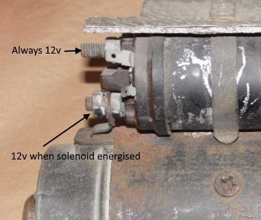

With your multimeter, and that same friend from above (but not The Darkness, and I don't mean Justin Hawkins either), check both points on the back of the starter:
Dolomite 1850 Starter test points.jpg (28.49 KiB) Viewed 2653 times
Get them to turn the key and the bottom terminal should read 12v, if it doesn't then you most likely have a sticking solenoid.
As to multimeter use, resistance checking can be useful, but looking for a voltage drop when checking for poor connections can be easier to do on a car. Check the voltage at the battery and then at the suspect location, and note the voltage differences. A large difference would suggest a poor connection somewhere causing a resistance, the infamous 'bad earth'* being an example. Once you have it narrowed down, swapping to resistance would help, high the ohms, worse the connection. Current checking, in my opinion, is not that useful as most meters only do up to 10amps, but it can be useful if you're chasing an illusive battery drain.
Hope that helps, and doesn't just confuse!
