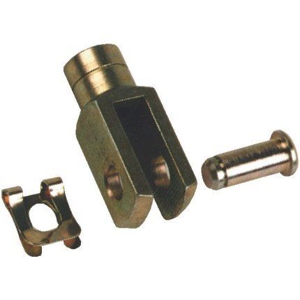

Well yeah, but I mean does this bit (below) unscrew as it does on some pushrods or is it welded on?! My new (Wilwood Girling clone) master cylinder pushrod has a 5/16" UNF thread, and the clevis question only just occurred to me as I was going to change it over Sunday but didn't want to take it all out and then put it back again. Guess I could use the old pushrod but I'd like to use the new one to reduce a bit of wear.

No, the OE has the fork welded to the rod.

There is no reason not to use the screw on type.
Just set it to the right length and it will be fine if you dont have the welded type.
These are used on P6 rovers too and have a lock nut so you can twiddle the rod to adjust its effective length and set the pedal height.

Use the screw on one,I have one on mine.It allows you to adjust the length of the pushrod so that you get full movement at the clutch slave cylinder.With the original set up,the clutch pedal will hit the carpet,before the clutch slave cylinder has moved fully.Your gearchange will feel a lot smoother as a result.
