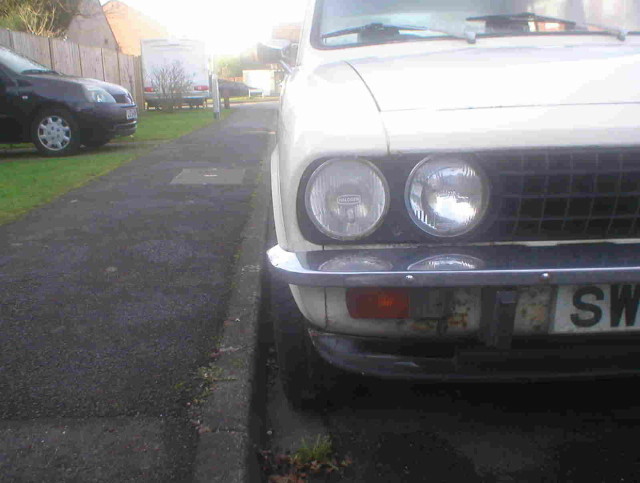

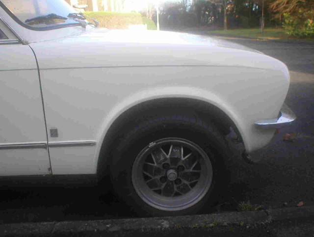

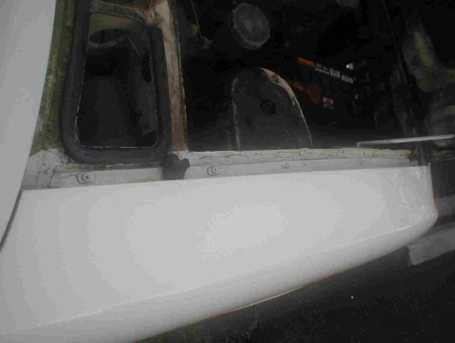

Hi Rich, Here are some piccys of how my OSF Club fibreglass wing fits on my 1850.
The fixings to the inner wing are MGB lower wing ones with Tigaseal (sp?) bonding all round.
Derek ( Autonet7 on here ) made an excellent job of fitting mine.
HTH,
OSF fibreglass wing.jpg (56.36 KiB) Viewed 904 times
OSF fibreglass wing top.jpg (45.81 KiB) Viewed 904 times
OSF fibreglass wing front.jpg (69.75 KiB) Viewed 904 times
