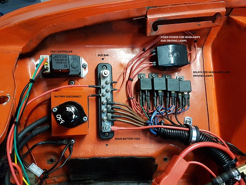

This is the way I upgraded mine. Bus bar has 150 amp capacity.
I got it from Auto Electrical Supplies
electrical upggrades.jpg (120.97 KiB) Viewed 787 times
