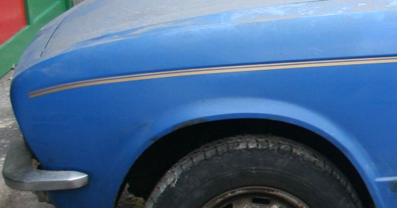

Here's how the stripes look on my 1977 1850HL. The top strip runs just below the crease in the body.
- Stripes.jpg (48.3 KiB) Viewed 2559 times

Thanks Mike, that's a useful picture, I've struggled to find close up pictures.
Given the slight curve on the front and rear wing, is it best to fit each panel coach line in turn? Most say do it all in one go and snip between wings and doors.

That's very interesting, as my very original 1850 shell has the fatter stripe to the top. also the front wing stripes taper together to a point at the front. The factory part numbers Alun gave refer to an individual and handed stripe for the front wings, this is why! Can't take any photos of it ATM as the body is 40 miles away at the panel shop being straightened.
As far as fitting the stripe goes, start at the back and work forward. Leave about 1/2" between the chrome moulding and the beginning of the stripe, but match the angle. If, as I suspect, you will only have a roll and not the specific front wing stripes, this will let you make the taper by hand. Note that the lower stripe is more or less flat all the way to the tip and the upper stripe tapers down to meet it. Once it's all on, slice the centre of each door gap with a razor blade and tuck the excess into the shuts, if you cut flush with the door/wing edge, the wretched stuff will shrink in time and leave a gap!
