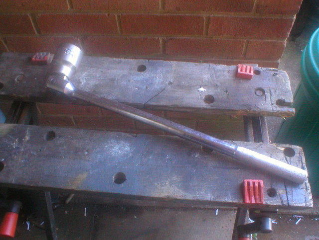

- Posts: 2336
Re: Crankshaft pulley nut
This is my solution to releasing the crank pulley nut. Its a 3/4 in drive breaker bar and a really solid socket. I have to use a 3/4 to 1/2 in drive adaptor for the torque wrench though.
- 1 point 5 in skt.jpg (89.93 KiB) Viewed 1501 times
