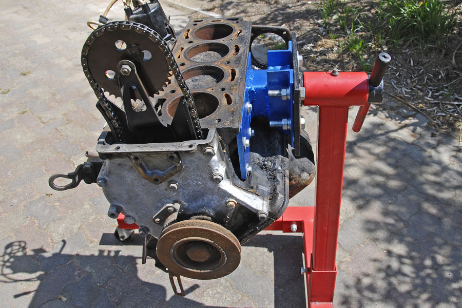

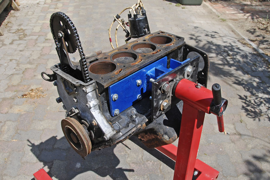

here is a photo of my version of mounting a Dolomite and Sprint block on its side as per Han's and Jeroen's method of attaching a block to an engine stand. It certainly works for me.

Mine is pretty much like Roberts above. Still scares me hanging the heaviest 4 cylinder block Ive ever lifted- on 4 5/16 bolts :shock: . Works a treat though and have built up complete with clutch.

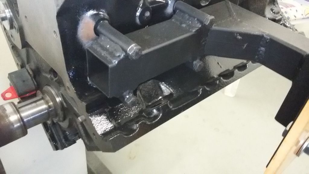

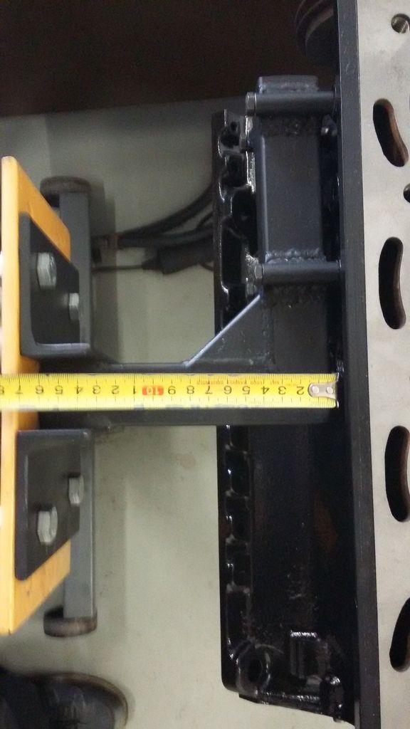

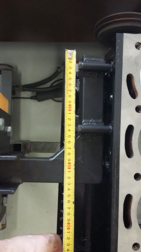

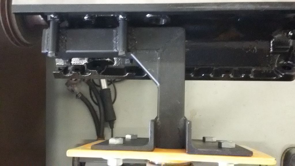

Jeroen, I would like to see the dimensions and pictures please. I could easily make my own. Thanks. When I rebuilt a Lotus-Ford block I hung it on the side and it was so much better than hanging it on the bellhousing plate.
Re: Engine stand Sprint engine mounting bracket
#13 Post by soe8m »

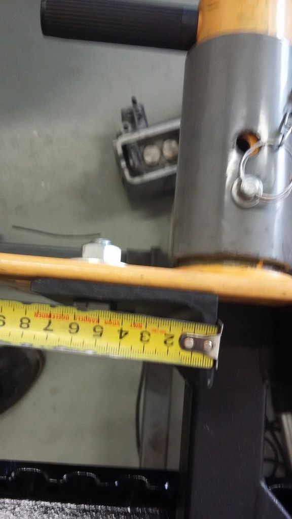

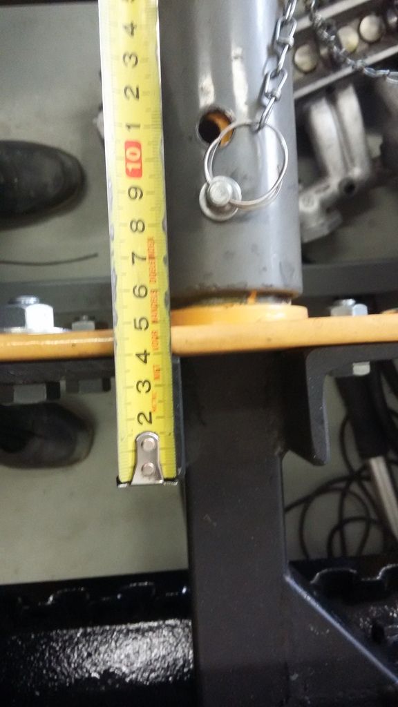

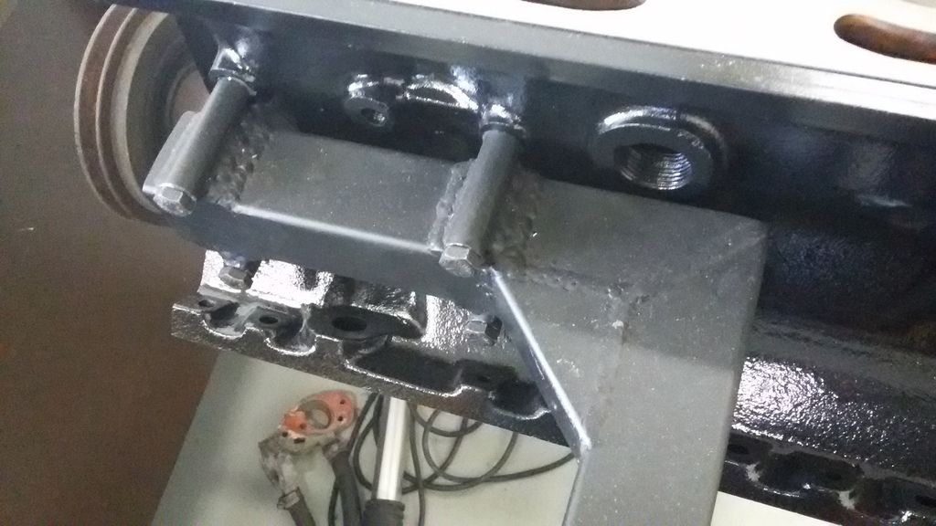

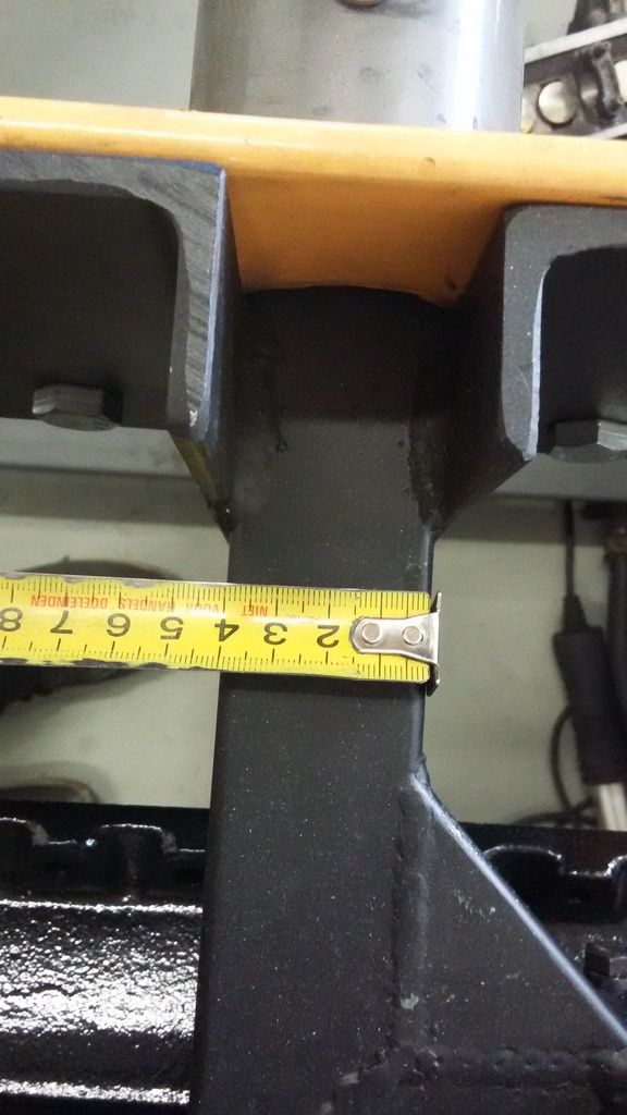

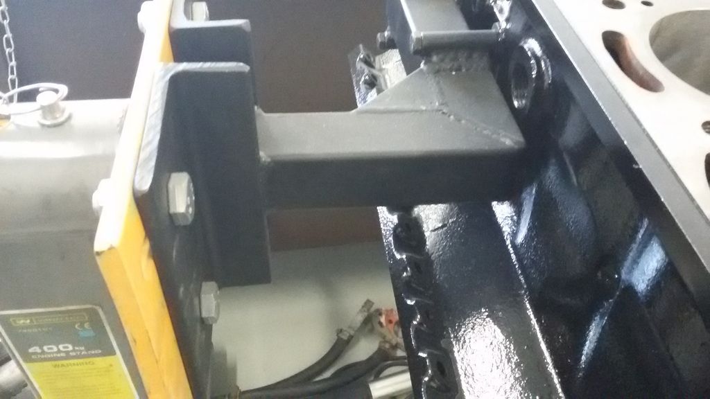

Not all pics as sharp but functional. In some pics it does seem the square tube of the adapter does stick inside the round tube of the stand and it does about 4cm. I used 40x40 and only had to grind of a bit of the angles to fit in the tube for extra support. The main 40x40 tube had a triangle cut out, then bend and welded. The piece what was cut out i did weld in the corner again. Make sure the 4 round tubes where the bolts are through are totally flat and flush with the engineblock. You have to bolt the four tubes first to the (an) engine and then weld the 40x40 tube inside. Then you are sure it does fit onto the engine.

Thanks, that's good. I can make some drawings from your photos. I assume the holes used for mounting on my 1850 block are the same as on a Sprint block. How strange to see a tape measure without inches on it! :D
