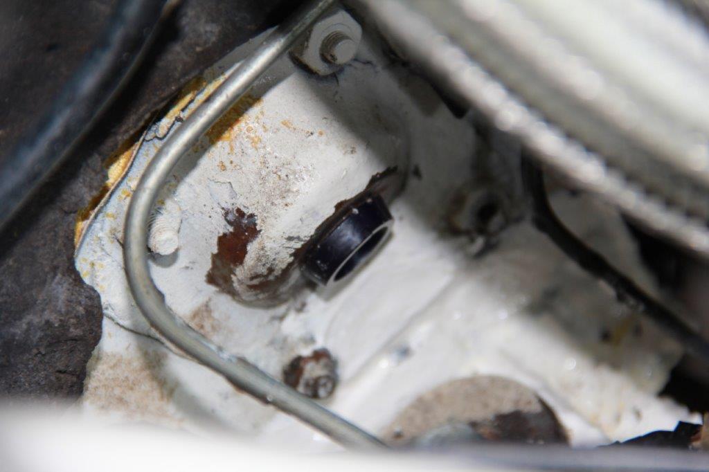

I have a superflex polybush fitted in my car. See pic. See also pic from BL repair manual talking about washers either side.
I also have a worn lower flexible joint which I intend to replace with a UJ per Rimmers alt. part. I'm considering swapping the bush around since the extent that it protrudes into the engine compartment seems excessive and makes aligning the parts a very snug fit.
However, I've realised that removing this poly bush would be impossible without destroying it. It also otherwise makes sense that's its fitted the way around that it is and its consistent with the repair manual. Opinions welcome.
Additionally, if my car ever had the plastic inboard washer and steel outboard washer it certainly doesn't now. I presume these sit against the column flange on the inside and protect the bush from the UJ on the outside. They do sound potentially useful but I don't know whether they can still be sourced and I can see the outer one might make things even tighter.
Thoughts? I have seen the other threads where the washers don't seem to be seen as necessary.
thanks

At first the bush is fitted the wrong way. I have never seen washers in that area other than the welded one. To align fit all and loosen the rack. Then tighten all. The uj replacing the flexi joint will be a big improvement in steering and durability.

I thought you were a fan of the bush being pushed through from the inside? That's how mine is - the wide flange is inside the car and the narrower deeper part within the engine bay

I do not know where you did read that but I can imagen I did say that once but in a certain context. I did own a lot of original dolomites to be sure there were no extra washers fitted and that the bush was pushed in from the engine side.

Thanks for that. You know the repair manual shows it being pushed through from the footwell side !
I was looking at changing it over earlier but :
a) I can see that it probably makes little difference but on balance you'd probably argue that pushing through from footwell side reduces the chance of the bush popping out. And its consistent with the repair manual. Does beg the question how it is you had original cars with the bush pushed through from the engine side. Usual BL quality control I expect
b) found there's no way you're going to remove a poly one without destroying it anyway (meaning any argument about it popping out is void in the first place)
Interesting with the UJ. I tried fitting it before and couldn't because the flat on the spline area was too short and prevented the necessary positioning. At the time I gave up. Today I lengthened the flat area with the angle grinder and I reckon it should be OK. If not, as you say, might need to shorten the std UJ shaft slightly.

You can remove the bush without damage by first removing the mounting plate

The 1973-75 parts book omits to show the bush at all, the 1976- one does, the part is a CRC360, or perhaps a UKC2322, there are rubber ones, poly ones and even a brass one, the Sprint repair manual shows it going in from engine side, but it might go in from the cabin side because that's what the amended parts book drawing suggests, on the TR7/8 it pushes in from the engine side, as it does on the Rover SD1, and all with countless TDC forum posts on the subject hilariously debating the pro's and con's with vigour on a regular basis!
Moral of the story, if it pops out you haven't fitted it properly so warm it up in hot water, lube up and insert
