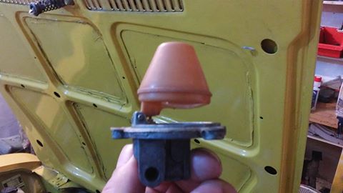

Could this be the reason? The SU manual says that the gap should be 0.125 but it's more like 3/8 inches. The other one is only slighter better. No adjustment is possible so it seems that the wrong valve/float has been fitted.Flyfisherman wrote: ↑Tue Jun 13, 2017 5:17 pm Mario

Re: Chugging Again!
Problem solved - PO fitted a washer which, once removed, let the float higher in the chamber. Will check whether this makes a difference to the 'chugging'

Re: Chugging Again!
That angle is not good of your float. The base has to be level or a tiny bit going up. I do sand a fiber washer to size to have the correct angle. Also the floatneedles come in sizes. A sprint does need the larger size. There are many parts in su's that look identical but are not and are easily mixed up.
