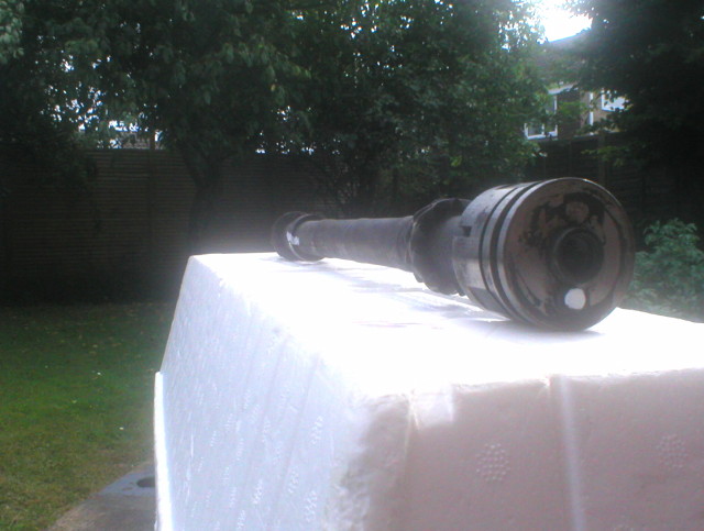

How to determine when the pump lever is at the lowest point of the operating cam ? I have a spare jackshaft here and the lowest point of the cam is with the dowel pin on the end of the cam right at the bottom. ( see photo ). So how does this relate to the crank position ? Looking at the timing chain set-up procedure in the workshop manual the dowel pin is at the left side of the jackshaft sprocket in line with scribed line, with the crank sprocket at TDC.Jon Tilson wrote: ↑Thu Jul 06, 2017 12:04 pm If this is a repeat of t he f-b thread by your own admission the old pump works fine, so why buy a new one?
In all cases refitting is a bind that is reduced by turning the engine so the pump cam is downwards thus less pressure on the arm as you fit it.
The screws are a bitch to relocate so some go for studs.
So to get the dowel pin at the bottom the jackshaft must be turned by 90 degrees, so the crank sprocket must be turned backwards through 180 degrees so the timing mark is at the bottom. It all helps to make fitting easier.
Early pump with the short operating arm is 312167.
Later pump with the long operating arm is TKC3419.
The gasket is 138791.
- slant jackshaft.jpg (73.3 KiB) Viewed 1394 times
