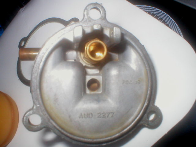

I had a misfire in the 1850 yesterday coming off the M4. The rev; counter was steady so I deduced a fuel problem. Pulling the choke out enabled me to get it home except for a smell of petrol. I discovered a steady drip of expensive carrot juice from the rear SU overflow pipe. So it was the usual float chamber lid off and have a look-see. There was a bit of gunge lodged in the needle valve orifice. A careful wash-out with carb cleaner showed it to be rubber rather than rust and there was another bit just behind it.
So I guess it started by partially blocking the orifice to give fuel starvation then moved furthur in to stop the valve closing and it flooded. Sorted for now.

- SU gunge.jpg (46.17 KiB) Viewed 682 times
