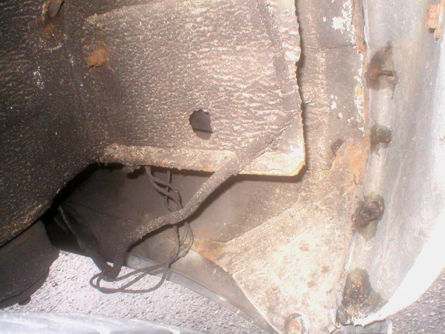

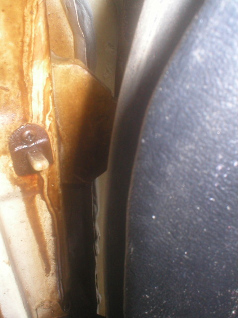

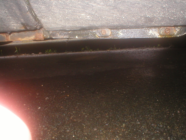

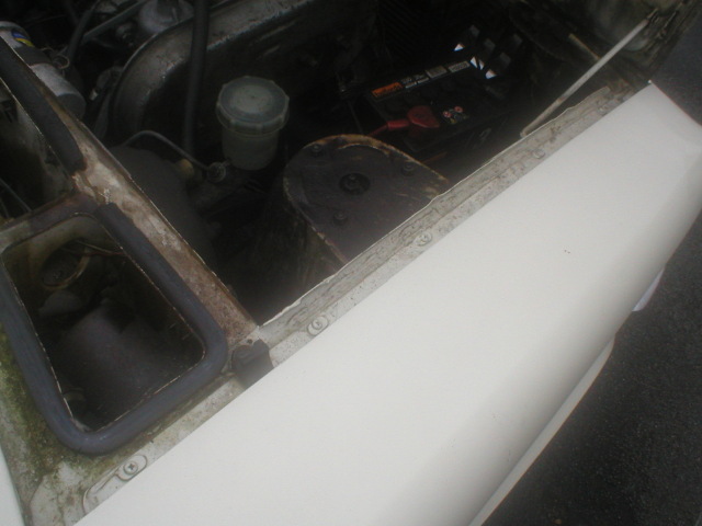

As promised to Bill, here is how mine are fitted.
Prep; and paint wise I'd have a word with Derek on here. I know he is quite busy at present so a quick answer might be forthcoming from your local Lotus spray-shop. Derek certainly got a nice finish on mine with no trouble.
As I think I mentioned the fixings are MGB front wing fixings. The rear edge is Tigasealed.
- top view fixings.jpg (70.74 KiB) Viewed 2112 times
- Lower rear edge.jpg (109.69 KiB) Viewed 2112 times
- Lower front inner.jpg (118.55 KiB) Viewed 2112 times
- Inner rear edge.jpg (69.98 KiB) Viewed 2112 times
