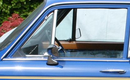

#8 Post by Bumpa »
I just put them as forward as they could go without fouling the opening of the quarter light.

Bumpa wrote: Sat Oct 20, 2018 12:05 pm I just put them as forward as they could go without fouling the opening of the quarter light.
That’s sound advice right there. My car only has a drivers door mirror that’s fitted in a position which doesn’t allow for the quarter light to open fully. Very annoying. I suppose the mirror was factory fitted, so points to another of BLs design flaws?

Bish wrote: Sat Oct 20, 2018 1:03 pm
That sounds about right..... Mine were both factory fitted and n/s one fouls the quarter light :(
