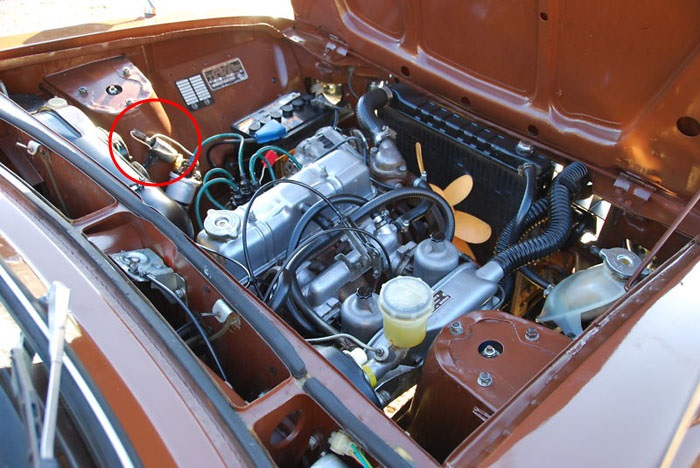

I'd ruled out the RF choke on the grounds that it has only the one wire, I'm assuming the OP means this thing I've ringed:Richard the old one wrote: ↑Fri Aug 03, 2018 6:45 pm ...plus a cable from a cylinder shaped suppressor to stop radio interference.
- Triumph dolomite 1500 hl engine bay cylinder.jpg (132.86 KiB) Viewed 1446 times

Is the 'small metal cylinder' the ballast resistor? Although I haven't seen one cylinder shaped...

Now I've seen this type of aluminium box with 2 wires coming out used with the very upmarket stereo systems of the 70's. Specifically Blaupunkt. You will probably find " Blaupunkt " engraved on the case if so. It is an in-line interference suppressor choke and is usually used with an interference reducing capacitor fitted from the coil positive to chassis via a self-tapping screw.
And its quite correct that Yellow / white is the supply input and the grey wire goes to the + on the coil.
Did you have a new ballasted type coil fitted ?
The white / slate grey wire goes to the rev; counter btw.
