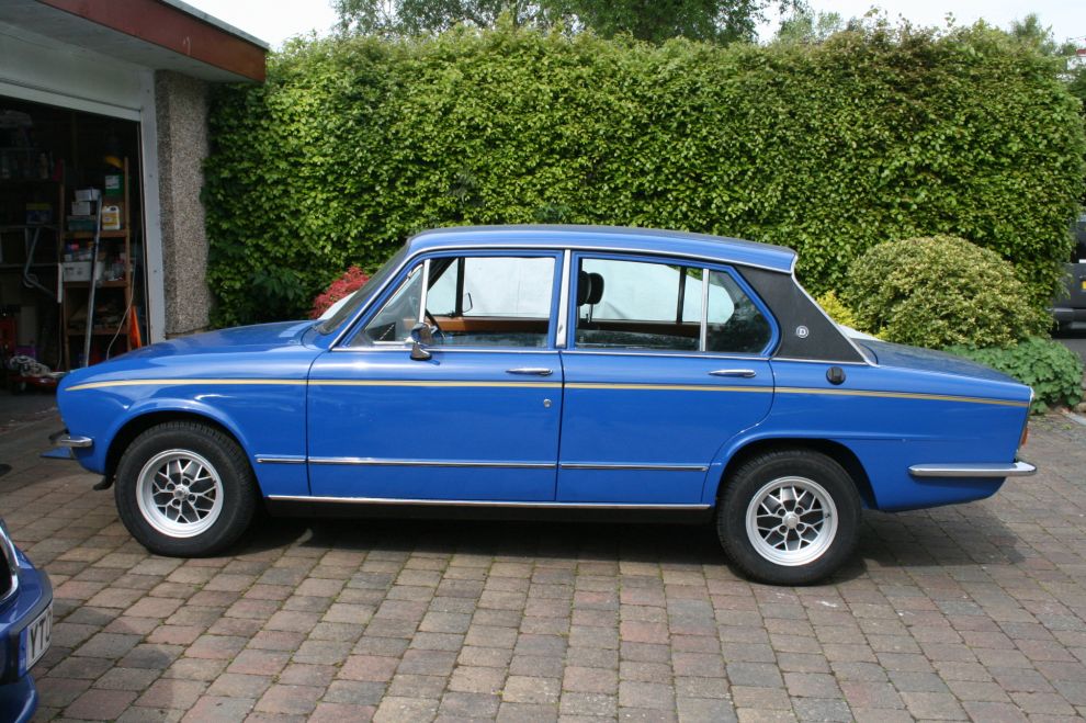

Well, since you asked... I have recently put my 1850HL back on the road after 26 years languishing in my brother-in-law's garage. It needed a little welding on the front of the sills which I did myself, and the paint was generally faded and very scruffy. I told my local body guy to do a cheap job because the car cost me nothing, and although I spent a fair bit on reconditioning it, it was still not worth a lot. I removed the front and rear screens and all the bright trim, but not the windows in the doors. It came back looking very good, although if you look carefully you will see some paint blemishes, and there is a bit of overspray on the door window rubbers. I'll rub that off one day - perhaps. What did he charge me?
£1000.
- 2018-05-21A.jpg (165.31 KiB) Viewed 1619 times

A grand is good value! Lovin the blue!

Thank you Steve, it's Tahiti Blue which is it's original colour. Despite the cheap job, it was sprayed in 2-pack and looks lovely. It certainly attracts a lot of attention. I've had men chasing me round the supermarket car park so they can have a look at it. When I went to the local Halfords, all the guys came out the shop to see it. I'm really enjoying driving it too. It's nippy enough to keep up with modern traffic, has excellent visibility all round, and is comfortable. Where you notice the age is with wind noise at 70 mph. Downsides are the heavy steering for parking (fine once rolling), fiddling with the choke for the first couple of miles, and the awkward selection of reverse on the single rail gearbox. Three times out of four I go into third gear instead of reverse.
