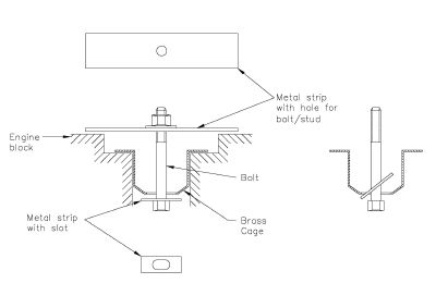

#5 Post by Mad Mart »
With something like this:-

#6 Post by xvivalve »
The 'strips' need to be quite robust!!

Mart did you create that drawing? if so what with? :)
Mad Mart wrote: Fri Jan 11, 2019 8:07 pm With something like this:-
Posts: 8529
Re: Waterpump stuck solid
#9 Post by Mad Mart »
I used AutoCAD. It was only a quick lashup. I can do a nice 3D drawing in Fusion 360 if you like. :wink:

On my 1850 getting the brass cage out was harder than removing the pump!. I made up a tool similar to the one in the drawing and Alun is dead right, the strips need to be strong. I used some thickish steel strips but they still bent before the damn thing finally gave up and came out. Its only held in with two rubber rings so it seems unfeasible that it could be stuck so tightly.

well that was easy once the extraction tool was made it slid out in a few seconds.
slide hammer made using a weight off another slide and the LH bolt welded on threaded bar.
Cage extractor is a long bolt with a cut down piece of scrap metal I had and a cut down Austin bumper iron.

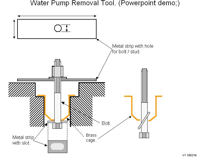

#13 Post by MIG Wielder »
tony g wrote: Mon Jan 14, 2019 6:13 am Clever :). I was hoping non cad types like me could do it on just a pc with no hassle.(cad screens are too involved for me lol)
Mad Mart wrote: Mon Jan 14, 2019 12:41 am I used AutoCAD. It was only a quick lashup. I can do a nice 3D drawing in Fusion 360 if you like. :wink:
I don't want to detract from Mart's absolutely excellent CAD drawing, but if you just want an electronic format mecchy drawing to give to a supplier it is possible to do the same thing with just Powerpoint running under XP.
Naturally it doesn't have all the clever CAD stuff behind the drawing that manufacturer's can use. It is just a picture. Here it is exported as a .jpg
Water Pump Removal Tool.jpg (39.98 KiB) Viewed 1380 times
