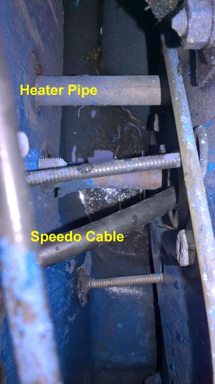

I can't see any sort of outlet for water that collects there. In my photo, is the drain somewhere under the speedo cable or nearer to the heater pipe?
- Drain for Heater Intake.jpg (109.47 KiB) Viewed 823 times

There are several small holes which drain the water away at the bottom of where your pool of water is, you need to get a wire coat hanger or similar to unblock your holes and then remove as much muck as you can

I would use something made from plastic to poke them out.

Such as a cable tie perhaps?

Thanks for the link to that article Keith. I shall have to get a cable tie and have a go!

i use air line and a hoover for those drainage holes/passages,work wonders
