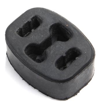

Stag owners seem to like these: http://www.partsforvolvosonline.com/pro ... 3ef5a41c1b
Edit: SOC post https://socforum.com/forum/forum/stag-o ... bber/page2
- md_049df17f-f9a4-4caa-9cbe-cac00a7e1f67.jpg (12.14 KiB) Viewed 2086 times
Re: split exhaust rubbers
£1.85 each!
