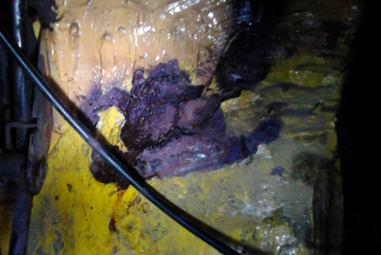

It is leaking from the engine bay - at least some water was draining out of the plenum and running along the rear right corner seam between cabin bay and inner wheelarch. As can be seen in the first pic, this is a bit rotten. That's the bonnet release cable running across and the side of the accelerator peddle on the left.

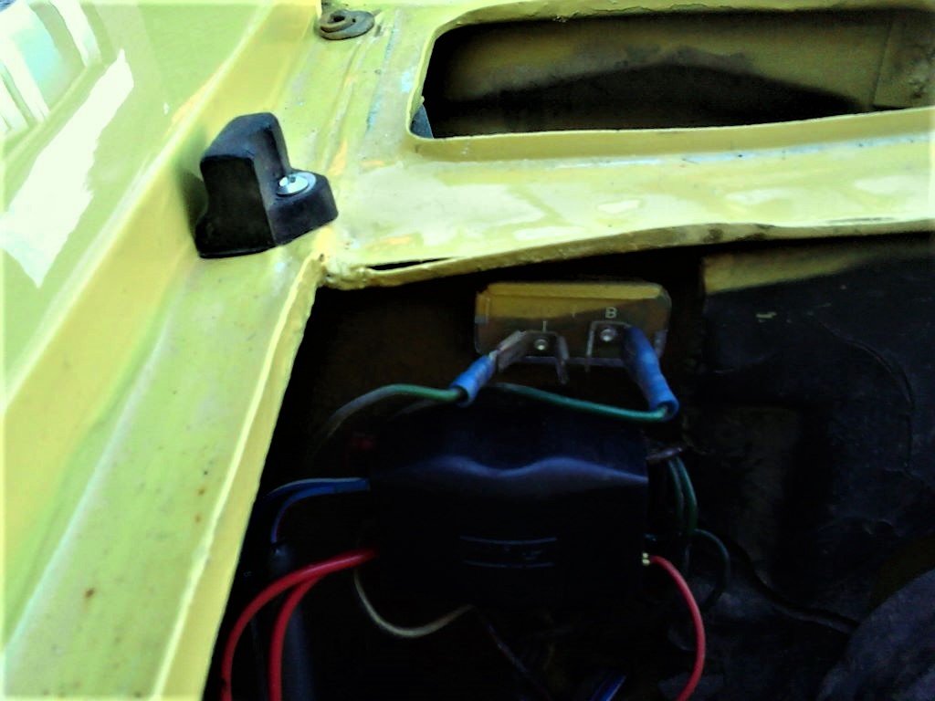

Some of the problem is shown in the second pic - water can just flow over the edge at the front of the plenum and run into the engine bay. I guess some of what rain gets in the plenum also ends up on the cabin floor too.
Not sure how I'm going to fix this. I may be able to glass down along the crack both sides. Maybe I can hammerite smooth the inside, then glass over that, and poor resin in the engine bay crack. My have to get another Big Boy FG kit. Not sure about fixing the gutter edge at the rear right corner of the engine bay. Looks like it needs unwelding and re-doing somehow.
Graham
