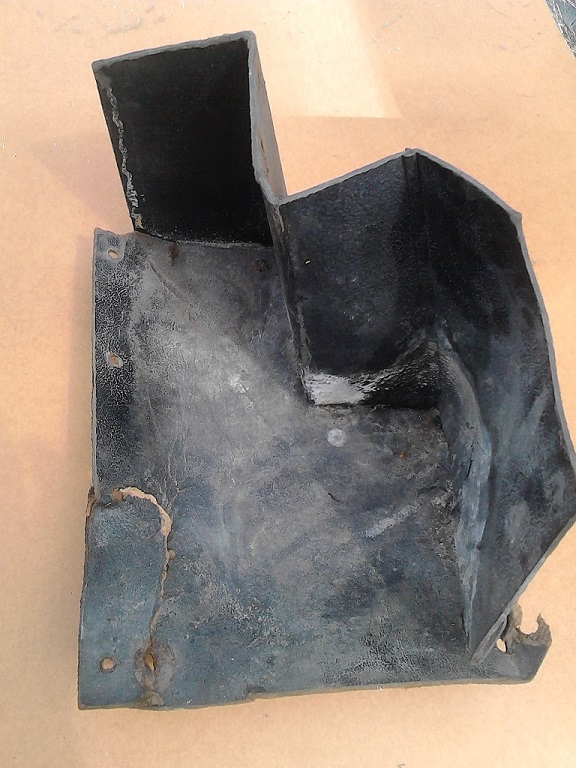

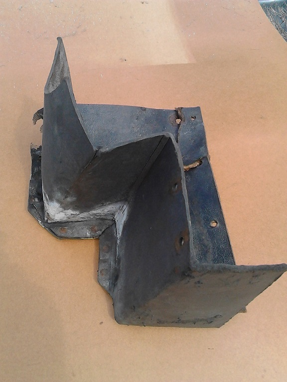

Got (found) some 3mm hardboard and used that to replace the base, coverd with some vinyl from re-covering the C post.
First two are of it as it came out, from this morning.
I used a load of 4mm x 20mm dia stainless penny washers and 4mm pop rivets to hold it all together - first time I ever had a pop rivet shaft break off halfway down. And the same to hold it to the front cross member of the shelf assembly. The two rivets on left hand that show, I used some small black washers I had, but I aren't that happy with having done them from underneath.
Last is as fitted - the mark is just some dust from sanding. I did take a little time to wet and unbend the millboard in the workmate - just letting it dry in the sun while held straight. That's made it a bit better. Maybe I could have slapped some paint on the bits before putting it back and fixing it in. Maybe I could have soaked them in resin or some such. But the speaker, which is waterproof, covers most of the worst of the remaining damage. I just didn't fancy it falling on me foot while I was driving.
Graham
