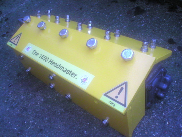

Hi Dave, I still have the "1850 Headmaster" cylinder head removal tool as per D.M. of about a year ago..

- threequarter viewVGA.jpg (111.62 KiB) Viewed 2458 times

Hey Tony,
That's a mean looking piece of equipment
Briefly, what's the principal behind it? (I'm sure I must have read it somewhere but it escapes me atm)
It's my head we're trying to remove btw.
Jeff
Jeff

- Posts: 2336
Re: head gasket
Hi Jeff / Dave,
The 1850 Headmaster is an 1850 ( and TR7) cylinder head removal tool for where the standard removal techniques have not worked.
It is based on the SOC "Head Honcho" and the TR7( USA group) designs, using the best features of both and improved where necessary.
An error on the drawings means the originals graunch on the timing chain case. This has been corrected here. The metal thickness has been increased to 13mm. A gusset has been added to the rear plate to increase rigidity.
The forcing bolt size has been increased from M10 to M16 and 2 flavours of forcing bolts are supplied.
Target head removal is as follows.
* Take care lifting it, the whole unit is very heavy.
* Remove exhaust manifold.
* Remove inlet manifold.
* Set 1 / 4 on firing stroke at TDC and separate the camshaft chain wheel from the cam as per the manual.
* Remove the camshaft.
* It is assumed that the stuck studs have been sitting in penetrating oil beforehand.
* Initially remove the 5 x M16 forcing bolts from the 1850HM and grease them well.
* Use the supplied exhaust manifold bolts to loosely bolt the vertical section to the target head.
* Use the supplied nuts and washers to loosely bolt the horizontal section of the 1850HM to the camshaft securing studs. The washers are to clear the unthreaded part of the studs.
* Gradually tighten the 7 exhaust manifold bolts and the 10 camshaft nuts and washers and torque them to the specified torque. Check it is all sitting square on the target head.
* There are 2 sets of five M16 forcing bolts supplied. 5 are counterbored to fit stuck but unbroken studs and 5 are turned down to go through the head stud orifices for sheared off studs or to do the 2nd stage lift. The special middle forcing bolts are colour coded in red.
* If one or more studs have actually been extracted then it is recommended that they are greased and then replaced to get an even lifting force.
* Using a quality ring spanner, the 5 forcing bolts can now be gradually and evenly tightened down. At which point the head should start to lift.
* When the countersunk forcing bolts have bottomed out, they can be removed and changed for the turned down bolts to get even more lift.
* Remove the 1850HM. ( Heavy ! )
* Pull the target head off the engine. It may be necessary to use wooden wedges to complete the lift or to push and pull the head up and down a few times to finally remove it.
HTH,
