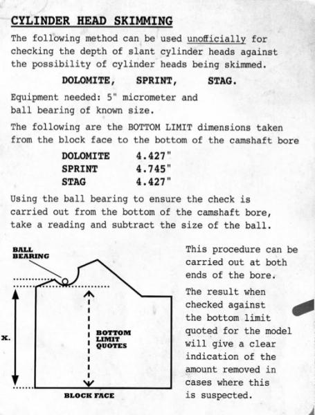

the 1850 had a broken head gasket , but the head was already overskimmed . So i :

this should be useful , for other users , thanks to Marshman who shared it

Hello,
Would these figures also count for the TR7 heads?
Regards,
Luke.
