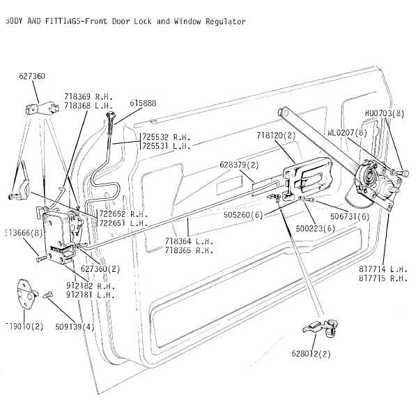

From the dolomite parts catalogue.

I would gess one of the clips that hold the rods in place has broke
Re: Drivers door lock issue
Door card off and nothing broken and all clips in place, Wd40 next to see if that helps
