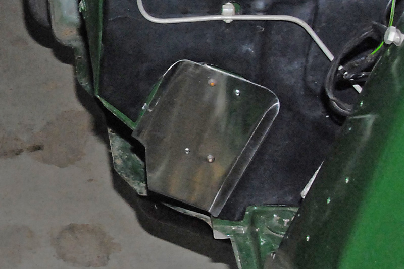

Steve is right. Bolt or screw the heat shield on so that if you ever have to drop the downpipe off the manifold all you have to do is remove the heat shield and then there is room to move the downpipe back off the manifold.
I lost my bulkhead heat shield and fabricated something out of a piece polished stainless steel I had lying around, reasoning that it would possibly do a better job with its polished surface than the original.
I am working on another Sprint at the moment and with the engine and sub frame out and the car sitting in my rotating jig I will be drilling heat shield rivets out and replacing them with some suitable nuts and bolts.
It will help then if the future owner ever has to remove the cylinder head while the engine is in the car.
This photo is of the shield fitted to HU 5000, the story of its restoration can be found elsewhere.
Robert
Robert
