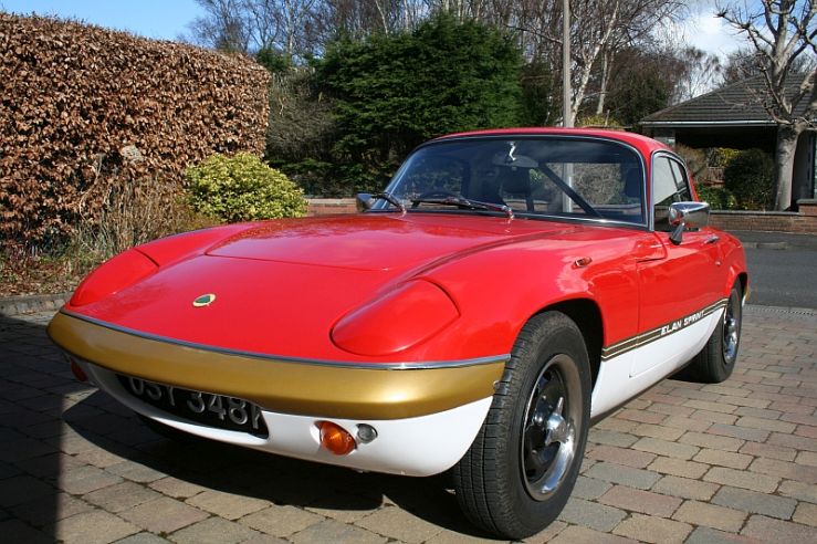

#5 Post by Bumpa »
I'm not thinking of painting my car myself, it just intrigued me when the article in the magazine said he had brush painted the car. I have some experience of that because I brush painted my Lotus Elan Sprint. As it was a fibreglass body, I used International Perfection yacht paint. There was a lot of flatting to be done but it turned out well as you can see. Hours and hours of work though. You wouldn't use that paint on a steel car - or would you? Trouble would be there is a very limited selection of colours. Fortunately the red and white were perfect for the Lotus.
