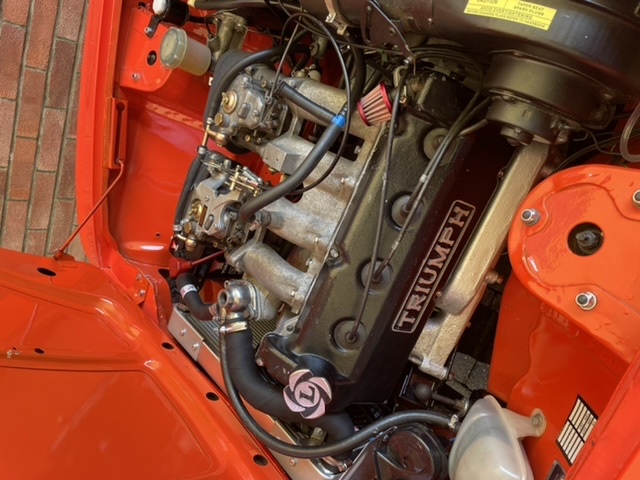

The car is already fitted with 40s but they are believed to be needing a major overhaul. I was going to take the manifold off anyway as I want to have it blasted and cleaned and was going to fit a 123 dizzy before the spring.
The rest of the engine is tip top so a straight change over for new 40s was the plan. Sell the old ones to recover a bit of cash.
I could go back to SUs but the car does run already on a 40s set up so hence new ones.
Any advise on the particular model of the Weber would help or the jet set up,
Any other advise gladly accepted.
Cheers.
Richard.

40's have almost twice the area...killysprint wrote: ↑Fri Dec 03, 2021 11:39 am If I remember correctly, the cross sectional area of the throttle opening on 40’s is the same or less than the std HS6 1 3/4” SU’s
45’s give that bigger throttle opening area and generally are seen as an upgrade. But not advised unless other mods are made along side, fitting them.
And a 205 GTI had injection….. 205 Rallye (not the Uk one) was a homologation special, and had 40’s as std. would love one!!
