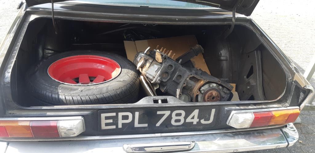

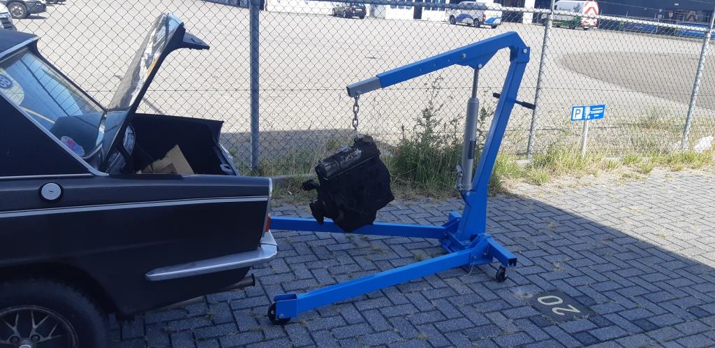

Got one today. A complete list of enginenumbers and interchangeable parts were not needed as there was a Dolomite 1300 engine laying around also. Not so common as most Dolomites here were 1850 and Sprint.

I wouldn't fancy trying to lift a heavy cast-iron engine block over the boot-sill of a Triumph Dolomite, for fear of damaging my back.
For two people, lifting a VW 1600 Type 2 air-cooled engine into a Triumph Toledo boot, with NO boot-sill was quite simple, involving no back strain.

naskeet wrote: I wouldn't fancy trying to lift a heavy cast-iron engine block over the boot-sill of a Triumph Dolomite, for fear of damaging my back.

soe8m wrote: ↑Tue Aug 30, 2022 9:20 pmnaskeet wrote: I wouldn't fancy trying to lift a heavy cast-iron engine block over the boot-sill of a Triumph Dolomite, for fear of damaging my back.
An engine hoist would certainly be useful, but I didn't have access to one of those!
