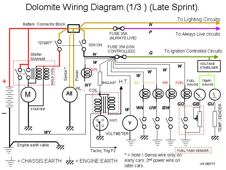

Have a look on the LHS of this wiring diagram.
The Pull-In solenoid coil is returned to earth through the starter brushes and commutator. So a faulty brush/ winding / even an earth on the starter main case will result in no pull-in coil operation.
The Hold-In coil is returned to earth via the solenoid casing but doesn't have enough energy to operate the starter.
It's going to be a case of bite the bullet and remove the whole thing I'm afraid, after checking for +12V on the large cable to the battery and the red/white cable from the IGN switch

Re: Starter Motor (late 1850 LHD) solenoid alternatives
The smaller spade connector with the white/yellow wire on goes to the Ignition coil "+" and is the +12V ballast resistor supply. It is only at +12V during starting.
I would maintain that it is very difficult to bench test the starter-solenoid as the Pull-in coil takes about 50 A from 12V . So will need chunky cables. It is also only designed to operate momentarily during initial key operation. It is going to get very hot if left on for even a few seconds.
The hold-in coil is more manageable taking only 15A but will still need chunky cables to bench test it.
Testing by substitution is the best way.
