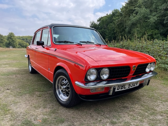

Got 195/60/13s on mine.
It sits a bit lower with gas shocks all round, but no rubbing, and no problems,
