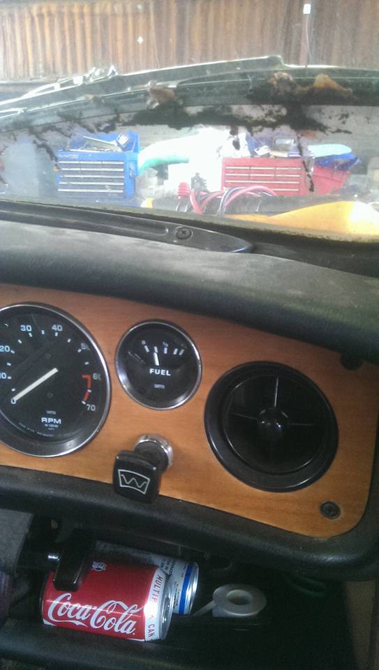

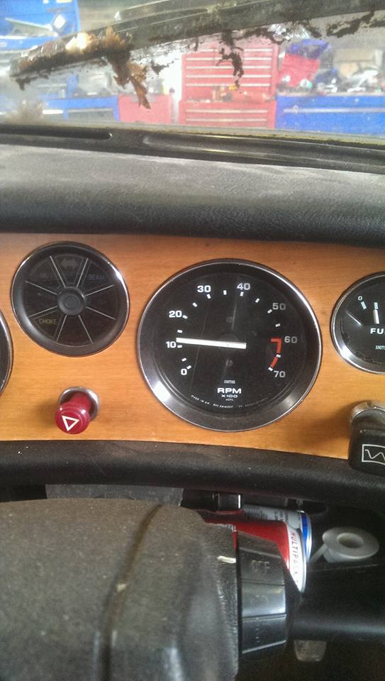

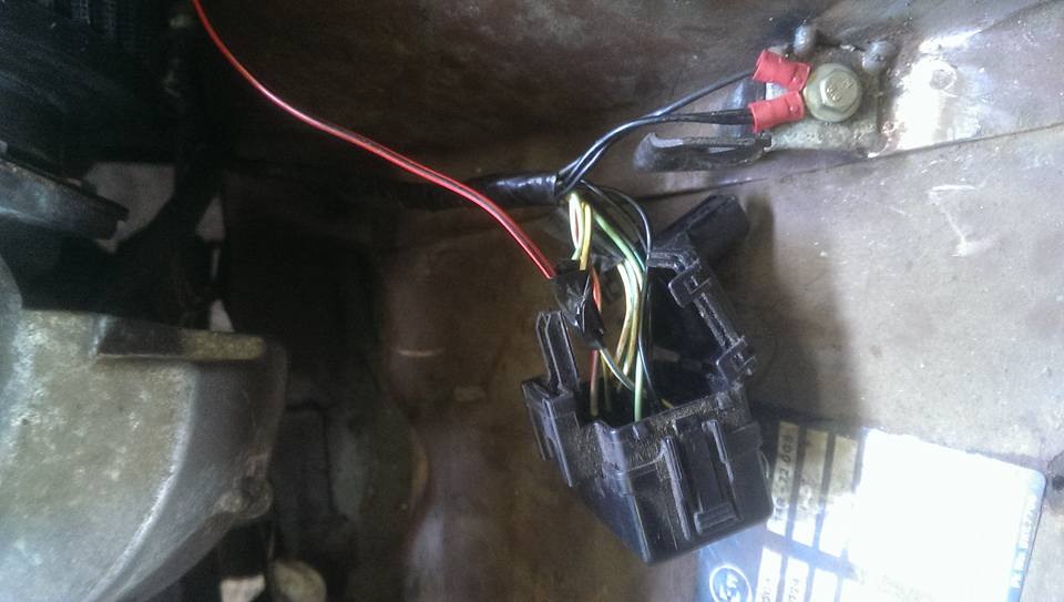

before i forget i will explain how i got the rev counter working. with the mazda wiring there is a diagnostic plug socket and going into that is a yellow and blue wire. this comes from the ignitor module and went to the dash aswell, so if you connect that wire up to what was the distributor side of the coil wiring the rev counter will work. ive also bled the clutch and it works fine with the dolomite master cylinder. mines a landrover one but its exactly the same just half the price. ive moved the car backwards and fowards and can select all gears with my temp gear lever till i make the final one. any questions just ask. will be back on here when i get home later.

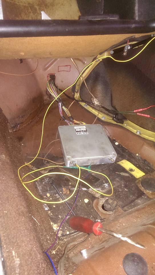

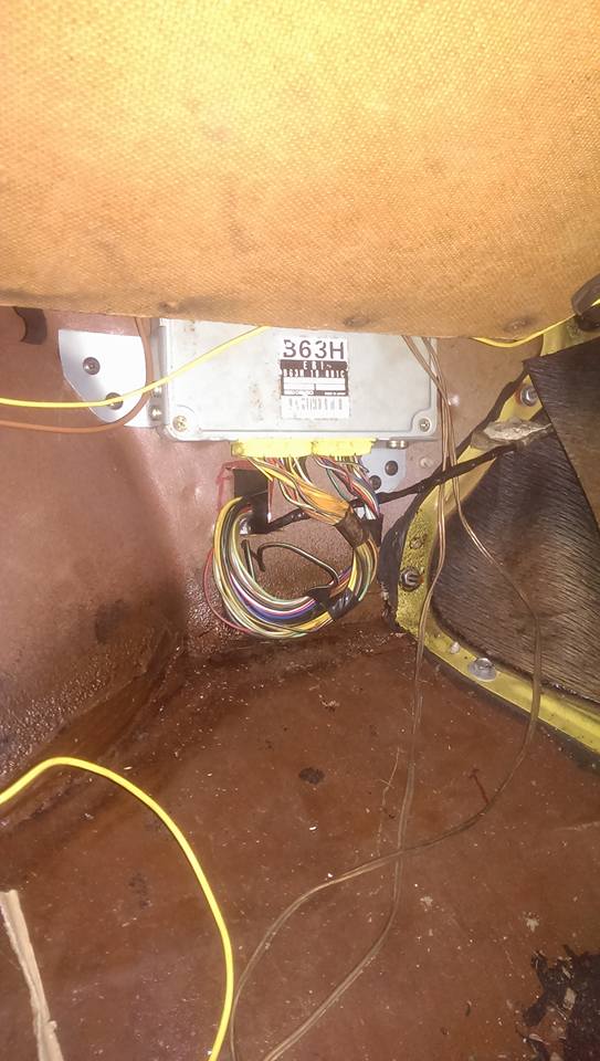

ecu needs fitting
ecu needs fitting

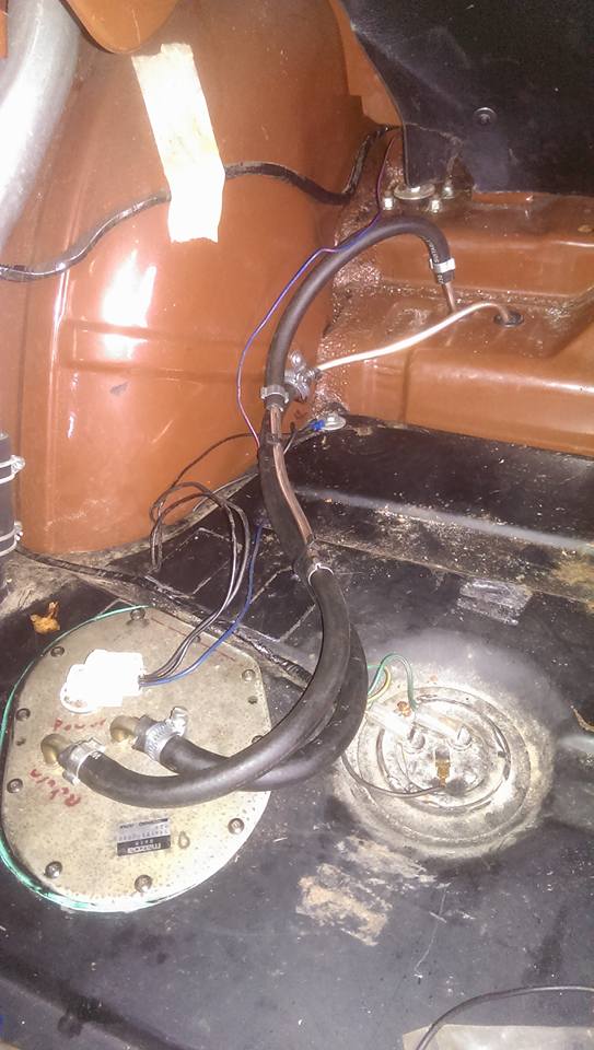

fuel tank. pipes need tiding up i just didnt have enough rubber hose.
rev counter wiring mod

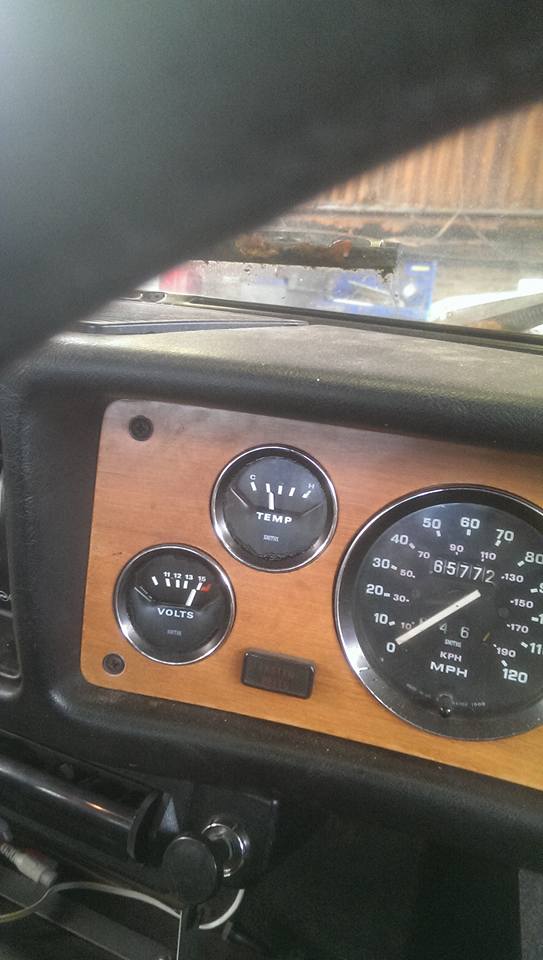

gauges working
gauges working
gauges working
gauges working
rev counter working
rev counter working

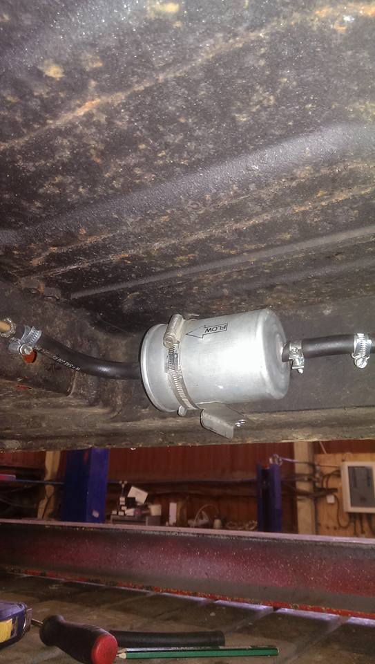

fuel filter bracket
fuel filter bracket
fuel filter fitted
fuel filter fitted

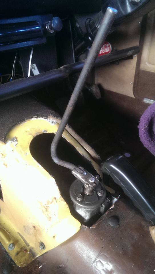

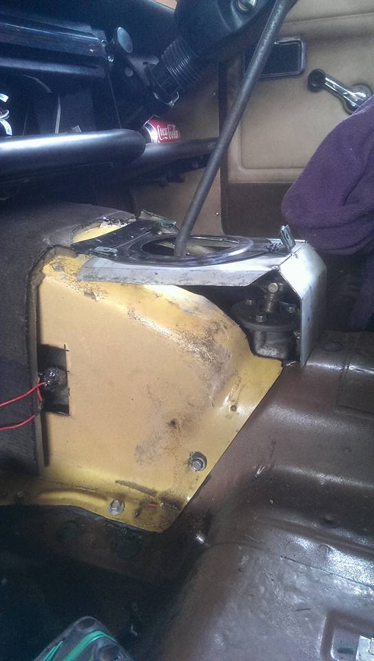

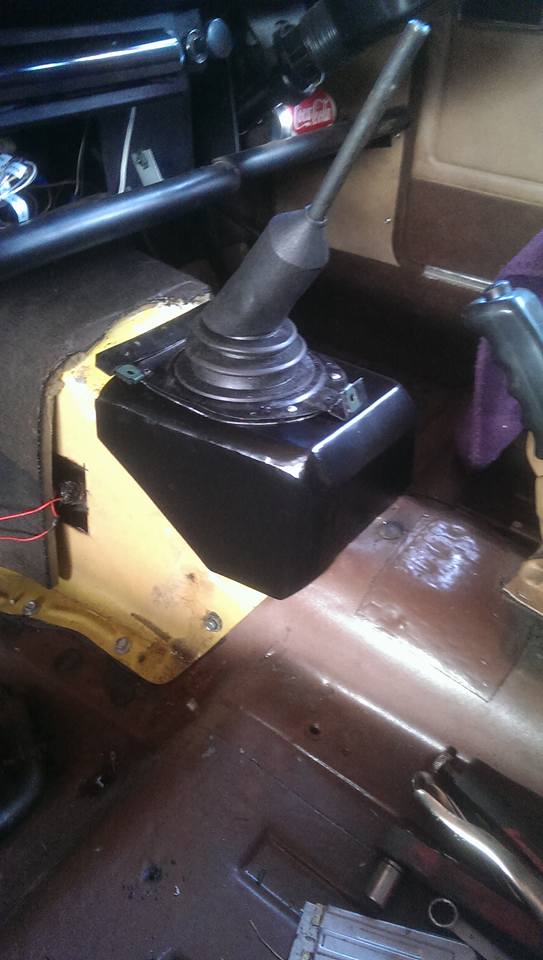

gearstick clamp
gearstick clamp
completed gearstick
completed gearstick

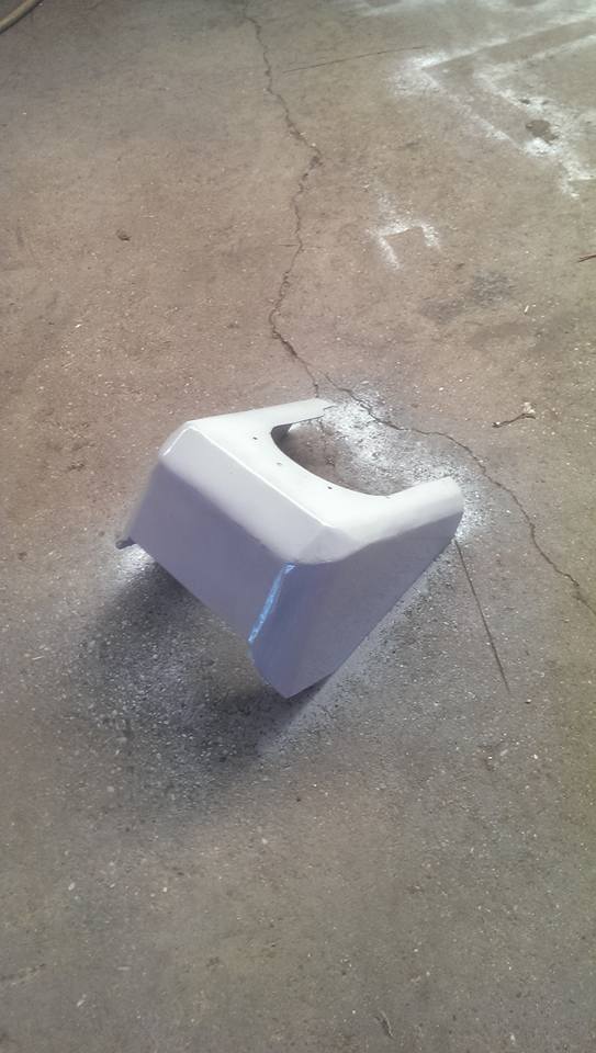

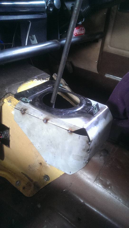

first sections of tunnel
gearbox tunnel tacked together
gearbox tunnel painted with primer
gearbox tunnel finished
still room to use handbrake

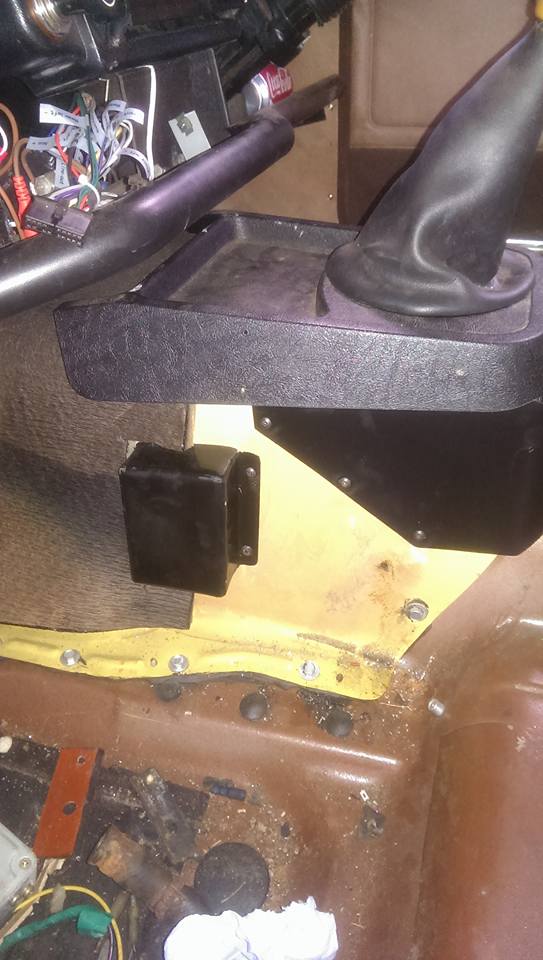

center console fitted

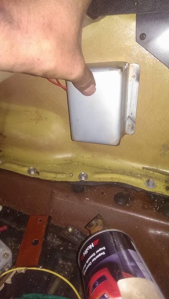

reverse sensor cover fabricated
reverse sensore cover fitted

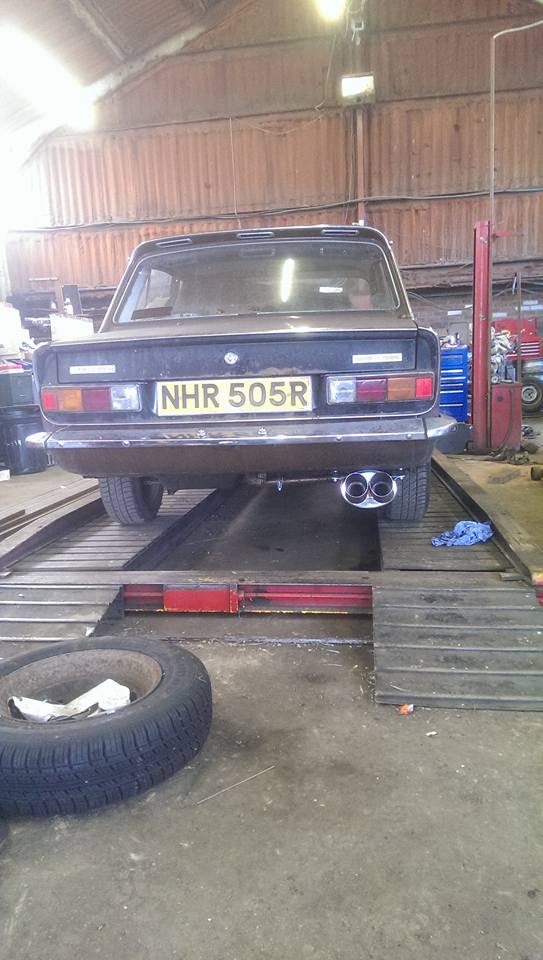

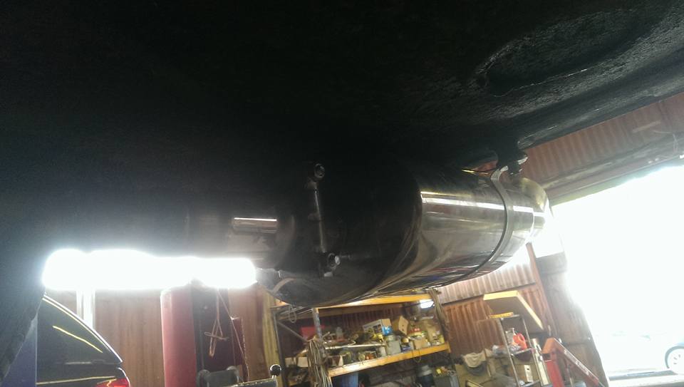

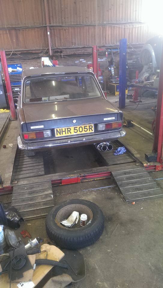

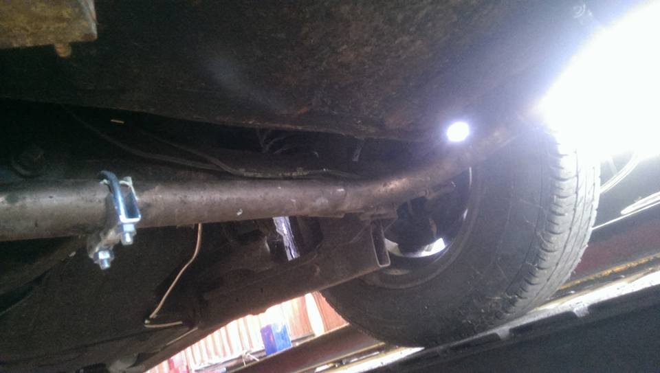

so today i have managed to fit my new exhaust back box. i did this by cutting out the old inline one, fabricating a bracket to hold new backbox to underside of car then used the pipe i cut off to connect the backbox up. it sounds alot nicer now. got a nice rumble to it. i will upload pics and video when i have a chance to.
philgroom
#27 Post by philgroom »
here are the pics of the exhaust, i have also put a video on you tube titled Nhr New back box. its being proccesed at the mo so might not work yet. i will keep checking it.
the section of pipe where the old back box used to be is the old tail pipe just turned around which was a perfect fit. i made the mounting braket out of 2 strips of stainless steel that i bent around the box. on each side of the box i bolted the strips to a rubber mount which i bolted through the boot floor,
ecu fitted in place
ecu fitted in place
view of size adaptor and mounting bracket

view from rear
view from rear
close view of twin outlets
section where old back box was
view from back
view from back
