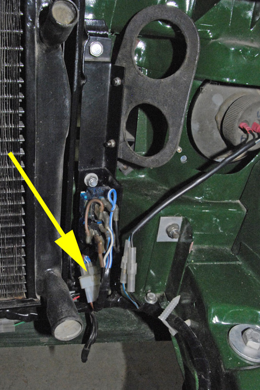

I too modified my wiring harness to incorporate headlamp relays when I restored my car. The photos shown here are duplicates of what I have shown on my restoration thread but I have marked the first photo to show where I broke into the wiring harness.
20121105-3630Ptw Headlamp relay position.jpg (202.41 KiB) Viewed 1809 times
There is a plug at this point which because I had the engine bay wiring harness out of the car at the time I changed for one with, if I recall correctly, 5 pins. It was a bit of a fiddle to push the original pins out of what I remember was a 4 pin plug but it can be done if you are careful. I took a 12 volt high current wire back to the main junction point on the harness which feeds from the battery across to the starter motor. I then re-taped everything with black tape to match the rest of the wiring harness.

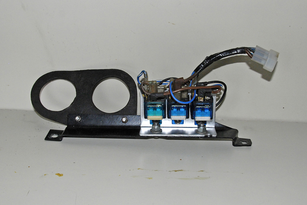

I remember following Tony – Mig Welder’s excellent diagram at the time but realised later that because the halogen dip lamps which I used do not incorporate a separate high beam filament, that it became necessary to fit a third relay so that when you switch to the high beam the dip beam remains on. The photo shown here shows the third relay all mounted on a simple bracket and bolted to the carburettor air intake support which is fitted on the Sprint.
20130302-4053Ptx HU5000 relay arrangement.jpg (194.57 KiB) Viewed 1809 times
Jonners commented at the time that he thought the relays might be exposed to water coming off the road. I have had no problems what so ever, so far. They are tucked in out of the way, the run from the relays to the lamps themselves is about as short as it is practical to make and the relays are in effect, hidden from view. Each relay is fused and the fuses are accessible if it becomes necessary to change them.

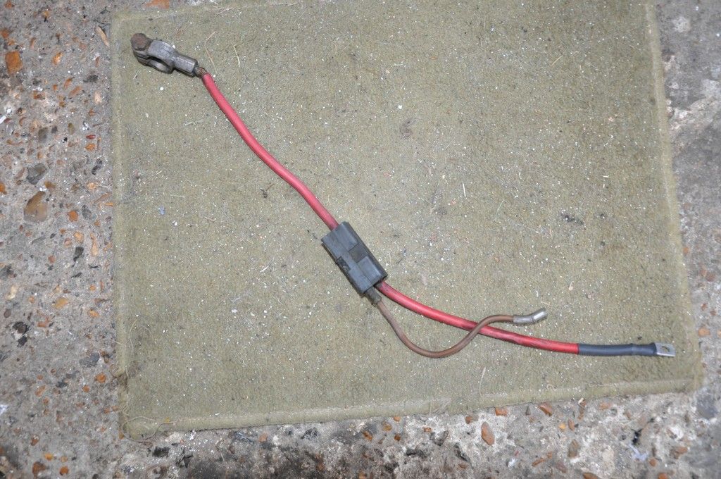

Richard the old one wrote:Toledo Man I like your simple way of picking up the + supply from the battery. So easy and simple I am glad that I still have to fit relays to my cars.
There's a much better option available to you Richard, Those RBY crimps really don't last well. No offence meant to you TM, they simply don't and it's all most people have available.
On OHV cars the battery king lead is a a simple beast so what I did was replace it with one from a Sprint/1850. This gives you 4 positions on the mid way connector block to take supplied from. It needs to be shortened ideally which since I have a 'tube' crimp tool I could do.
The attached brown wire feeds the starter relay I fitted a couple of years earlier. Up to that point I'd used ring crimps behind the battery bolt which failed due to the slight wiggling they get each time the battery is disconnected. After a similar replacement failed too I did the job properly as above. Some time later when I got around to fitting relays on the lights I have 3 ready and waiting feeds to use.
I put a 4 way fuse box next to the battery, jumper for the 3rd fuse still missing at this point:
I got the fuse box slightly too close to the battery, getting the lid off with the battery in place is a fiddle, an inch further up next time.
I put the relays between the inner & outer front panels using stainless self tappers:

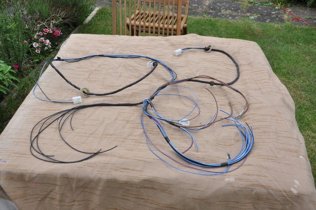

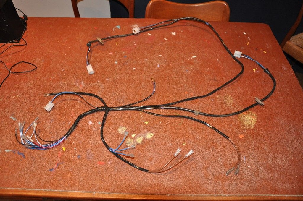

I made a custom loom which is a 3 stage process.
First you make it up with every wire over long and just a few bits of tape round it as strategic points.
Then you fit it to the car, cut all the wires to the correct length and fit any crimps that seem like they should be done in situ.
Then you remove the whole thing, fit the rest of the crimps and wrap it removing the insulating tape as you go. This is it removed and ready for stage 3.
This is the loom finished bar one connector shell.
Bundle of terminals bottom left - Relays
Big ring crimp middle left - 0V, goes behind the same bolt on the inner front panel as the battery 0V to body.
Middle bottom 5 terminals - fuse box
Bottom right two - Feed from the king lead.
Dead center - These are round crimps like the OE ones on the car, these went into a 3 way shell and plugged into the car loom.
I fitted 75w inner sealed beams and the usual Halogen outers. The reason I used 3 fuses not two was that I used wire sizes that would allow me to got to 100/80w outers and 120w inners.
No cutting of the loom. No current path longer than it needs to be. Totally reversible. Only damage to the car is three holes for the relays and one for the fuse box (I used an existing hole IIRC one side). Click the last picture to go to the album with more pictures.
