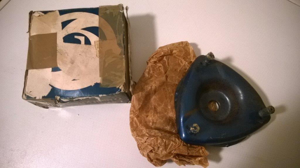

#20 Post by olr159w »
Here is the correct part supplied by Mick Dolphin. Hopefully all back onto the car this weekend.
Why am I sharing? Firstly to applaud his help, customer service and packing prowess.
But also for a small nostalgia moment. When was the last time you saw an original part in an original box? It even had that olde worlde oiled paper wrapping. And the box and paper smelled like they had just been retrieved from a distant shelf by the storeman in a brown coat !
