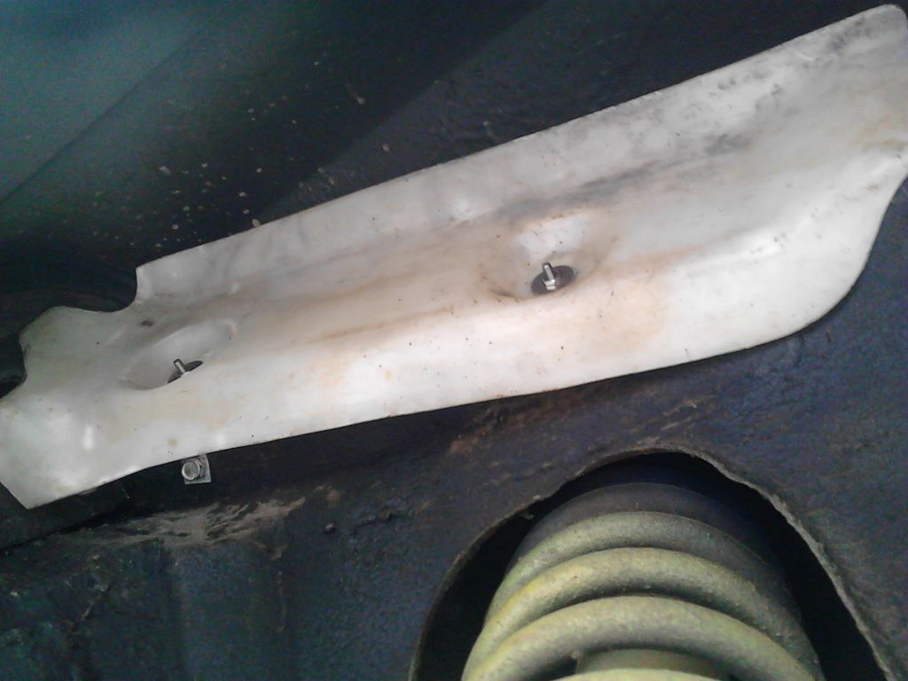

Came to fit the upper rear mudshields Alun sent me, and found out why there was only one with the car: there are no fixing holes on the LH side of the car.
Worse, there's no chance I'll get my drill in there to make some.
Doesn't look like the hot glue gun's an option either. If only I'd know about it when the wing was off.
By LH I mean the drivers side.
But that's because it's a Left Hand Drive car.

Would a right angle drill attachment get sufficiently close?

I would think so. I'm ebaying right now.

I can drill the front hole with an angled drive, but the back one's too tight.
I think I can bolt a poundlands best, right angle bracket to the back of the shield, and get to the inner wing side of underneath the strengthener to screw a stainless no 8 self tapper in there. Maybe I can do that for both ends, and I don't need the right angle drive. If I use a countersunk bolt betwixt shield and bracket, that'll move the shield right by the thickness of the bracket alone. About 2mm. I think that'll be okay.

Or use Tigerseal

Well I finally got the damned thing on: when I came to fit the steel plates at the back of the wheel arch, they needed a bit of work first. I did it with the right angle brackets, though I ended up using No. 14 self tappers with 10mm af heads.
