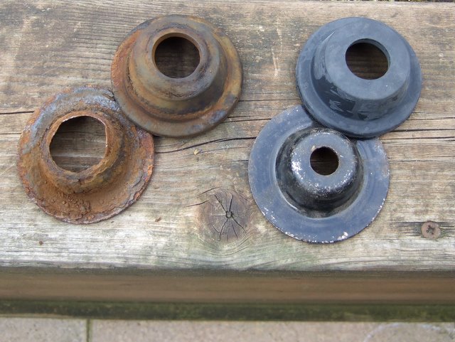

Just went out to the garage to have a quick look at the problem, and discovered that both rear cups have gone! :shock: The subframe has dropped at the back, it's a good job that my wife didn't carry on driving.
I am now wondering if one had already gone, causing the strange engine vibrations we've been getting, and eventually the strain proved too much for the other one.
A pair of new cups, lower rubbers (one has disappeared), bolts and nuts have been ordered and will be fitted as soon as they arrive.

Mmmmmm, it shouldn't really look like this! :shock: Especially not when it's BOTH sides.

#109 Post by Jon Tilson »
That is undoubtedly what happened.
I have had this happen to me twice....once just like you when the remaining one dropped. I hadn't realised the other side had gone either. This was in the Sprint and luckily only a mile from the house...after the normal 40 mile commute home on the motorway at the usual continental....so I got away with it but the last mile was interesting.
Also happened to the yellow peril. I retrieved the bits from the road and refitted some spare ones within 5 minutes of getting back home. Once bitten...
You can get and I have on some of my fleet a non cupped poly rear sub frame mounting with a flat base, and this uses a big flat washer instead of the cup.
This cant rust away invisibly cos its stainless too.....but needs a slightly longer bolt which it came with, and a mounting spiggot too.
Not sure if you can still get this kit but worth finding.

#110 Post by Howard81 »
Yikes, that's nasty :shock: Glad it happened not to far from home.. a simple fix at least.. and a good opportunity to slip in some poly mounts :mrgreen:

Changed the subframe washers last night, there wasn't much left of the old ones! :shock:

#114 Post by DoloWIGHTY »
:o Jeepers they did need doing! :shock:

#115 Post by JPB »
*Clears throat*. SOMEONE, let us refer to him as "X" Didn't know that these cups were obtainable new, so, on discovering that those on his own car were almost at the point of breaking through, carefully repaired them with dished repair washers. If only I... sorry; someone :( :oops: had known that he could have saved himself hours of measuring, grinding, welding, more grinding, turning, more grinding, etc. :oops:
Still, looking on the bright side; at least doing this job gives you the chance to have a good poke to make certain that the surrounding metalwork is all good.
