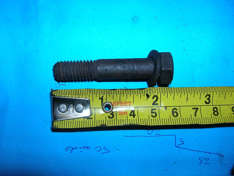

Here is one of the brake disc bolts from my 1850HL which is in pieces at the moment. The bolt is 3/8" UNC and 2" long.
- Disc Bolt.JPG (449.75 KiB) Viewed 960 times
Re: Hub to disc bolts
That bolt is part number 157157. Mick Dolphin has them listed on his spreadsheet at £1.50 each. It isn't listed in my hardware catalogue and Rimmer Bros don't list it on their website either so I can't get any specs. The above photo is the best we have so far. The spring washer is WL209 (also listed under GHF333) which is a 3/8" spring washer.
